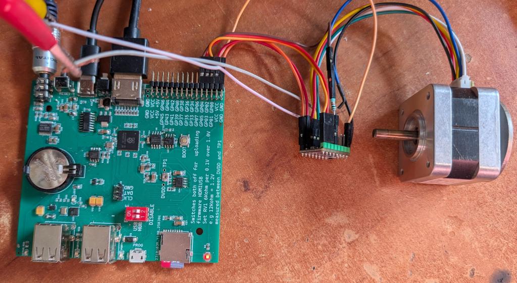

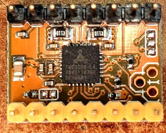

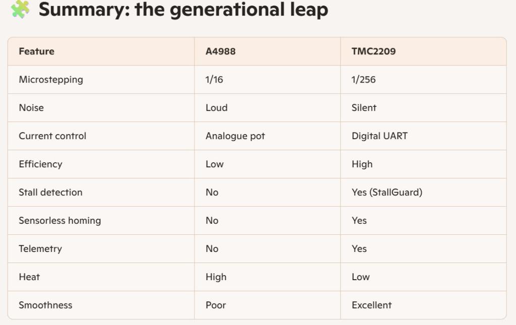

For years now the maker community has standardised on 16-pin modules to drive stepper motors. Originally, many of these were based on the A4988 stepper driver chip. More recently the TMC2208 and TMC2209 have come to dominate as "next generation" controllers. Compared to the A4988 they have numerous enhancements.
The A4988 modules were configured by setting jumpers on the PCB and the output power was set using the tiny potentiometer on the module although this was very much a black art.
The TMC2208/9 can also be configured the same way to some extent but, much better, they have a uart I/F to allow all of the capabilities of the driver to be exploited. However, as ever, with the increased capability comes increased complexity.
I have therefore included a new command in the RP2350 versions of MMBasic - TMC22xx that handles all that for you. This is covered in detail in the stepper manual
Stepper_Reference.pdf

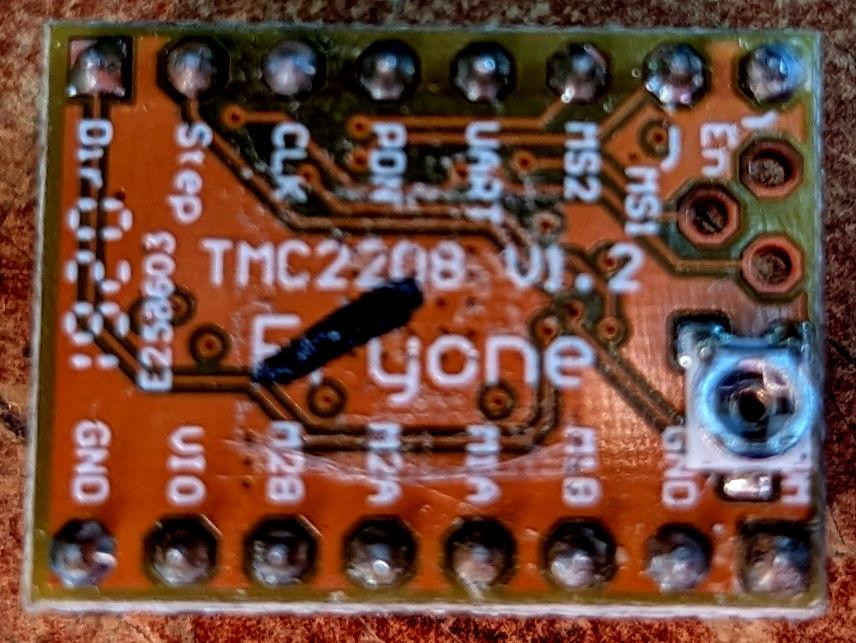

Over and above the standard step,direction and enable pins, one extra pin is required and is connected to the driver's uart input via a 1K resistor. This can be any pin on the PicoMite as the serial TX is bitbanged using the same code as the DRIVER SerialTX command.
Using this to control the driver, no other configuration is required and the normal config pins on the driver can be left unconnected (they have internal pulldowns). For the TMC2208, each driver needs its own UART connection. For the TMC2209 a sinle UART pin can be used as the config pins are then available to set an address 0-3. This is explained in the manual.
So the complete wiring is as follows:
PicoMite any pin : Driver step pin
PicoMite any pin : Driver direction pin
PicoMite any pin : Driver enable pin
PicoMite any pin : Driver UART pin
PicoMite GND : Driver GND pin next to VCC pin
PicoMite 3.3V : Driver VDD pin
12V supply GND : Driver GND pin next to VIN
12V supply +ve : Driver VIN pin
DRIVER MS1/MS2 pins: pull to 3.3V to change address (0-3) - TMC2209 only
With this all wired you can move the stepper by setting the direction pin in MMbasic and then pulsing the step pin. Or, of course, you can use the stepper command framework to have full gcode control over up to 4 stepper motors.
Const dir = "GP1"
Const steppin = "GP3"
Const enable = "GP0"
Const uart = "GP5"
s$="g0 a10"
On error skip
Stepper close
TMC22xx uart,2209,0,1000,50,4,,0
Pause 100
initstepper
Stepper gs s$
Stepper gc g0 a0
Do :Loop While Peek(stepper active)
Sub InitStepper
 Stepper Init
 Stepper Axis a, steppin, dir, enable, 1, 1600, 400, 10
 Stepper POSition a, 1
 Stepper Run 1
End Sub
