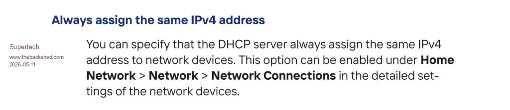

Supertech
Joined: 13/11/2016
Posts: 67
Posted: 07:41pm 10 May 2026
First I dont have any Fritz!boxes. I have had very good success in stability of reliable connection 'irrispective of what Webmite is WiFi connected to', or via. Yes it is your equipment at fault, not so much webmite itself, as I have proven on multiple tests of both stock standard W and W2 Pi-Pico's. In fact, 4 at a time, rock steady proven written my own Uptime out at 3 months stable success, no rebooting.
Thus I pose this in your setup:-
Crucial is 'static' IP at your WiFi router!
Try these steps for your Fritz setup.
1. Get manual,
https://fritz.com/en/pages/service-fritz-box-7590-ax#multicolumn
2. Page 129, manually assign your set IPADDRESS$ into your Fritz!box main router irrespective of extenders on system. If asks reboot, do so.
As stated, this is just suggestion.
Regards to All. Supertech
ville56
Joined: 08/06/2022
Location: Austria
Posts: 646
Posted: 04:13am 11 May 2026
Supertech,
thank you for your input, but I'm running that kind of MAC-based "static IP" since long time. What I will try out later is setting an IP address in the Pico itself and assigning that to an "non-DHCP" IP range in the router, so avoiding DHCP at all for the Pico. Will see if that changes anything.
73 de OE1HGA, Gerald
