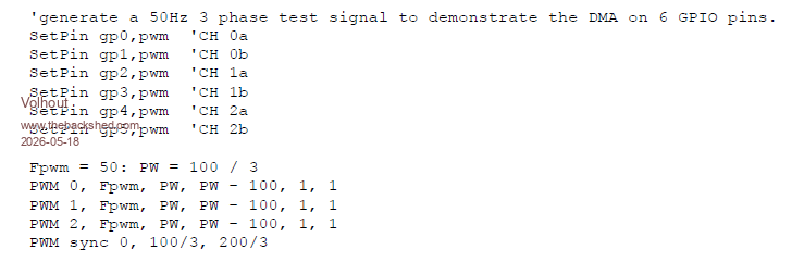

Posts: 6195
Posted: 06:42am 18 May 2026
@lizby,
If you need exactly inverted outputs, from a single PWM, you can use negative PWM values. Note that the PWM value is a float, so you can get resolution that is built in the PWM hardware.
Pico peripherals work at 60-ish MHz (63 or 66). So when you run a 60kHz PWM you can get 10 bit resolution (2^10 = 1024). When you run 15kHz it will be 12 bit.
The PWM's have 2 outputs A and B.
PWM n,freq,duty,-duty
will get you what you want. A has "duty" as dutycycle, B has "100%-duty" as dutycycle. The dead time has to be made in hardware.
But to drive an H bridge, you often need 2 PWM controlled pulses with 180 degrees phase difference. Then you can use 2 different PWM, that you phase lock. Then use output A from PWM1 and output A from PWM2 to drive the H bridge. You need to use PWM SYNC to start the 2 PWM's simultaneous. Now you can have A a duty cycle of 20%, and B also with duty cycle 20%, but they are 180 degrees appart. The dead time is now also easy to implement: have a maximum duty cycle of 49% (not 50%).
IF you look at example 3 in the user manual appendix F (this appendix is about PIO) it shows in a few lines (Phill's idea) how to create 6 H bridge signals for a 3 phase H bridge from 3 independent PWM's that are phase locked. Note, this is 50Hz, and they are 120 degrees appart.
In this example it is used to demo a simple logic analyzer running on PIO. But the test signal can be used to do what you need.
Edited 2026-05-18 16:49 by Volhout
