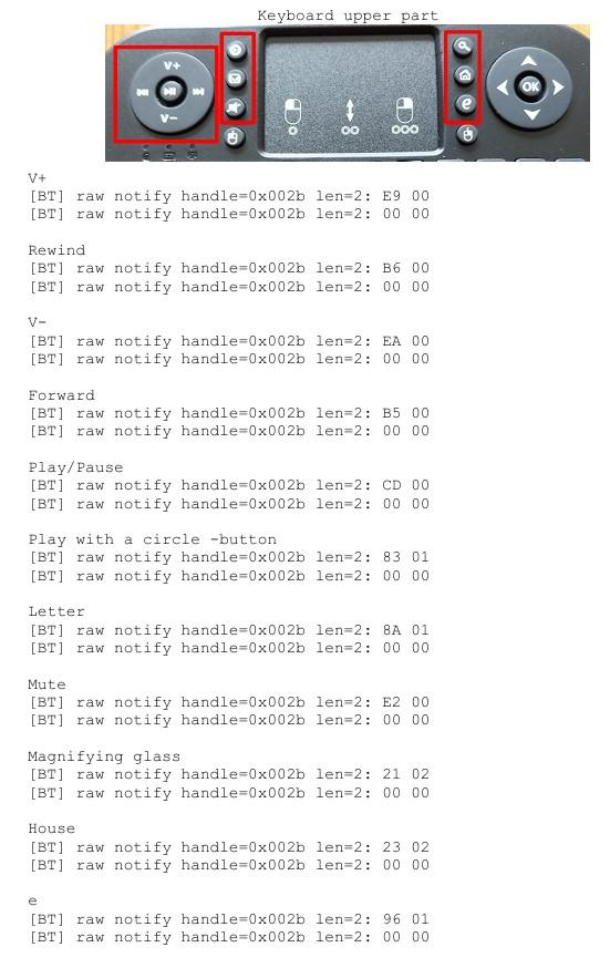

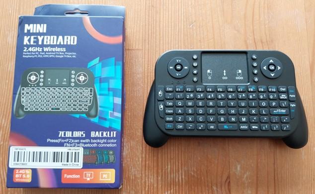

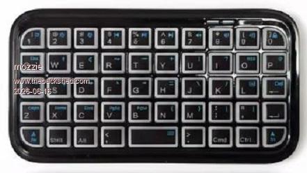

Peter63
Joined: 28/07/2017
Location: Sweden
Posts: 217

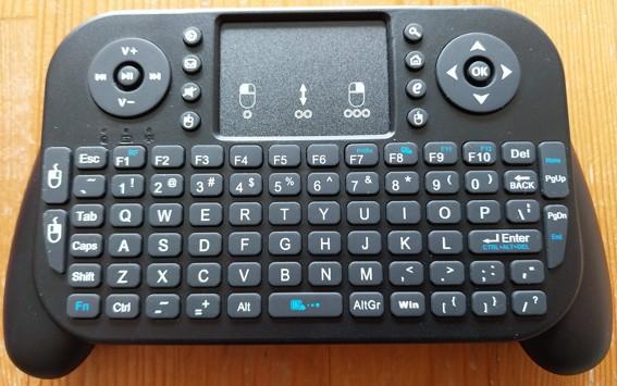

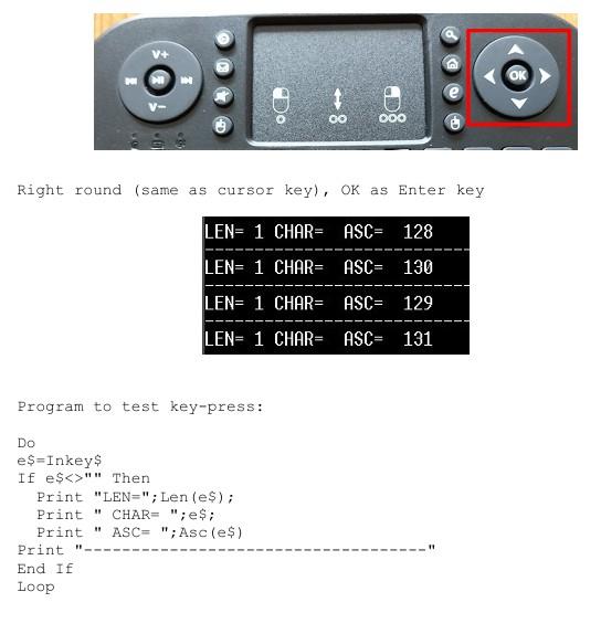

Posted: 02:48pm 22 May 2026
a few more tests I did on the mini keyboard
I can't get the trackpad to work, nor the mouse buttons.
/Peter63

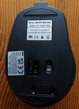

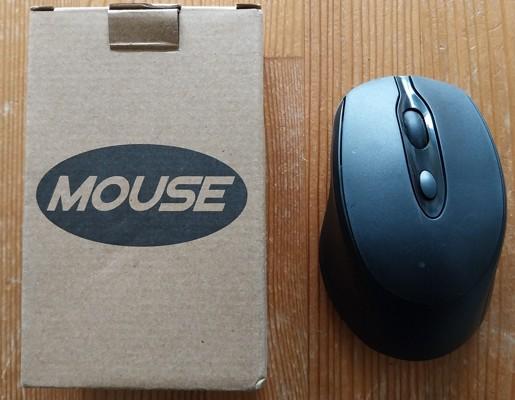

Hello, Peter
I thought I would try this mouse.
I don't really know how to test this, what device number does a BT mouse get?
/Peter63
Posts: 12051
Posted: 07:12am 23 May 2026
  Quote  what device number does a BT mouse get?
It will always get 2 unless already occupied, Keyboard 1, mouse 2, gamepad 3

Tested the mouse with this program:
xold=DEVICE(mouse 2,X)
yold=DEVICE(mouse 2,Y)
x=DEVICE(mouse 2,X)
y=DEVICE(mouse 2,Y)
b=DEVICE(mouse 2,L)
r=DEVICE(mouse 2,R)
m=DEVICE(mouse 2,M)
d=DEVICE(mouse 2,D)
If x<>xold Or y<>yold Then Print "X";x;:xold=x: Print " Y";y:yold=y
If b Then Print "Left mouse button":Pause 200
If r Then Print "Right mouse button":Pause 200
If m Then Print "Middle mouse button":Pause 200
If d Then Print "Double click of the left mouse button":Pause 200
End
, and it works.
The middle button was the one that did not work on this mouse.
/Peter63
Peter63
Joined: 28/07/2017
Location: Sweden
Posts: 217
Posted: 09:31am 23 May 2026
I tested the mini keyboard again. Wanted to see if the trackpad worked, and sure enough it worked. Used the same program that I used when I tested the mouse.
/Peter63

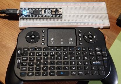

Posts: 12051
Posted: 02:58pm 03 Jun 2026
Just tested with this :
and it works nicely

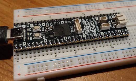

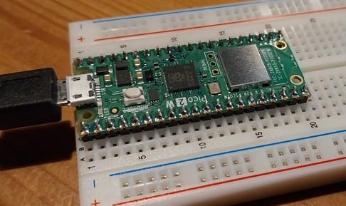

Posted: 02:19am 04 Jun 2026
I have tested version RC15 on the original Pico 2W, works fine.
Also tested on Pimoroni Pico LiPo 2 XLW, but does not work.
> option list
PicoMiteBTH MMBasic RP2350B V6.03.00RC15
OPTION FLASH SIZE 16777216
OPTION COLOURCODE ON
OPTION KEYBOARD US
OPTION PICO OFF
OPTION CPUSPEED (KHz) 200000
Both were completely new, before loading RC15
/Peter63

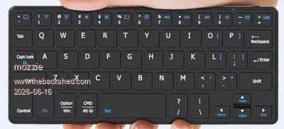

mozzie
Joined: 15/06/2020
Posts: 469
Posted: 04:07pm 15 Jun 2026
G'day,

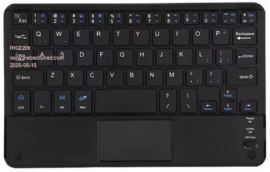

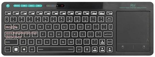

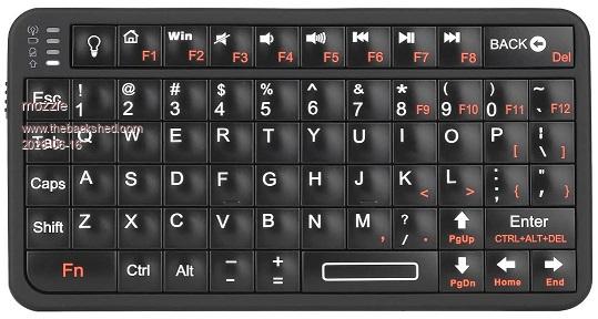

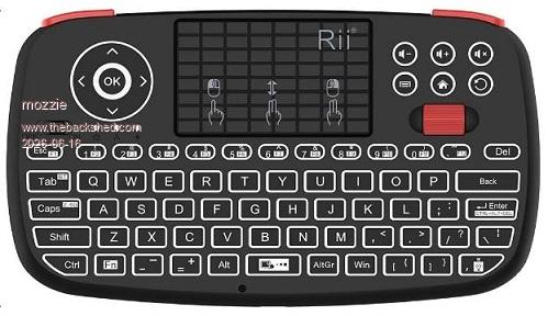

Results of some testing for reference. Original RP Pico2W.
Keyboards listed as BlueTooth 4 or 5 seem to work fine, BlueTooth 3 (only one sample) does not.
Generic "Bewinner" 7-8" bluetooth keyboard, usually comes in "leather" folder for tablet.
Works well, big enough to type on, no backlight.
Generic "Micro" bluetooth keyboard. Do yourself a favour and spend a bit more on the Rii 518bt.
Works, too small for easy typing, has backlight.
Rii I4 dual mode keyboard / trackpad.
Works well, too small for easy typing, trackpad works, has backlight.
Rii RT518S dual mode keyboard / trackpad. Be careful, the K18 looks identical but is 2.4Ghz only.
Works well, big enough to type on, trackpad works, has backlight.
Rii 518BT keyboard.
Works well, key shape makes it fairly good to type on despite tiny size, has backlight.
The Rii keyboards are a bit more expensive than the generic stuff but seem to be pretty consistant. I have a few others and they survive abuse in the workshop quite well.
Only things that fail to work are the scroll wheel / scroll function and the CAPS LOCK LED.
Thanks again to Peter for implementing this, could prove to be very handy.
Regards, Lyle.

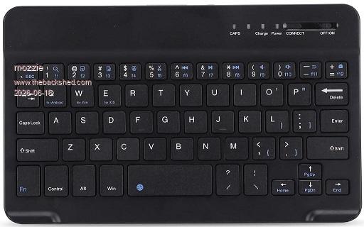

mozzie
Joined: 15/06/2020
Posts: 469
Posted: 04:13pm 15 Jun 2026
And those that didn't work:
Generic "Magnetic Bluetooth keyboard / touchpad", this shows as "BlueTooth 3"
And be wary of these, no function keys could make life difficult.
Regards, Lyle.

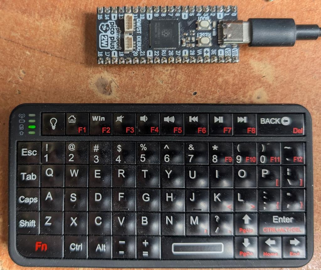

Peter63
Joined: 28/07/2017
Location: Sweden
Posts: 217
Posted: 07:44am 25 Jun 2026
Tested version: PicoMiteBTH MMBasic RP2350B V6.03.00RC24
Just letting you know that my little mini keyboard (BT) works on version RC24
Using-board: Pimoroni Pico LiPo 2 XLW (PIM776)
> option list
OPTION KEYBOARD US
OPTION HEARTBEAT OFF
OPTION PICO OFF
> Bluetooth Keyboard Connected
 /Peter63
