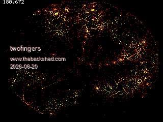

This was an experiment in asking Claude to optimise the bubble universe program. It's first attempt in Basic was to create a sine/cos lookup table which slowed the program down. It then suggested a CSUB so I coached it through how to write one, how to make it RP2040/RP2350 agnostic and how to deal with floating point numbers. I did this by getting it to slowly go through a number of simple examples, squaring an integer, then squaring a float. We then moved on to optimising the bubble universe. On a HDMI build at 378MHz the frame rate increases from 5.1 to 42.4FPS.
The next step is to improve the whole csub architecture to make writing them a bit easier. There will be a python script to generate a csub direct from the c source.

[29] Memory pack nn,Peek(varaddr m(0,a)),66,32
Error : Address not divisible by 8
The lone and ...
Posts: 11826
Posted: 12:20pm 20 Jun 2026
Works for me, hdmi and tft - you don't say what firmware and version you are running on

I commented out the memory pack/unpack code and am getting a displayed value of approximately 26.45 (at 315MHz); I just don't know if the output was affected.
With the Tracecache enabled, a cycle takes 25.7 ms (= 38.9 at 315 MHz).

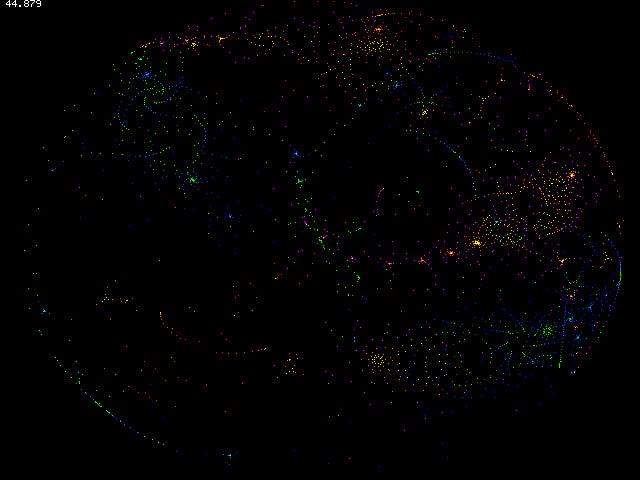

Posted: 04:54pm 20 Jun 2026
Hi Peter,
I launched Bubble Universe on CSUB steroids,
PicoMiteHDMI MMBasic RP2350A Edition V6.03.00RC21
OPTION FLASH SIZE 4194304
OPTION COLOURCODE ON
OPTION KEYBOARD US
OPTION KEYBOARD PINS GP2,GP3
OPTION RESOLUTION 640x480 @ 315000KHz
OPTION HDMI PINS  1, 3, 5, 7
OPTION SDCARD GP5, GP6, GP7, GP4
OPTION AUDIO I2S GP10,GP9', ON PWM CHANNEL 11
OPTION PSRAM PIN GP8
and here's the result for me:
MODE 1 -- 28.5mS 35fps
MODE 2 -- 27.7mS 36fps
MODE 3 -- 44.9mS 22fps
! MODE 3 worked only with the PSRAM connected
