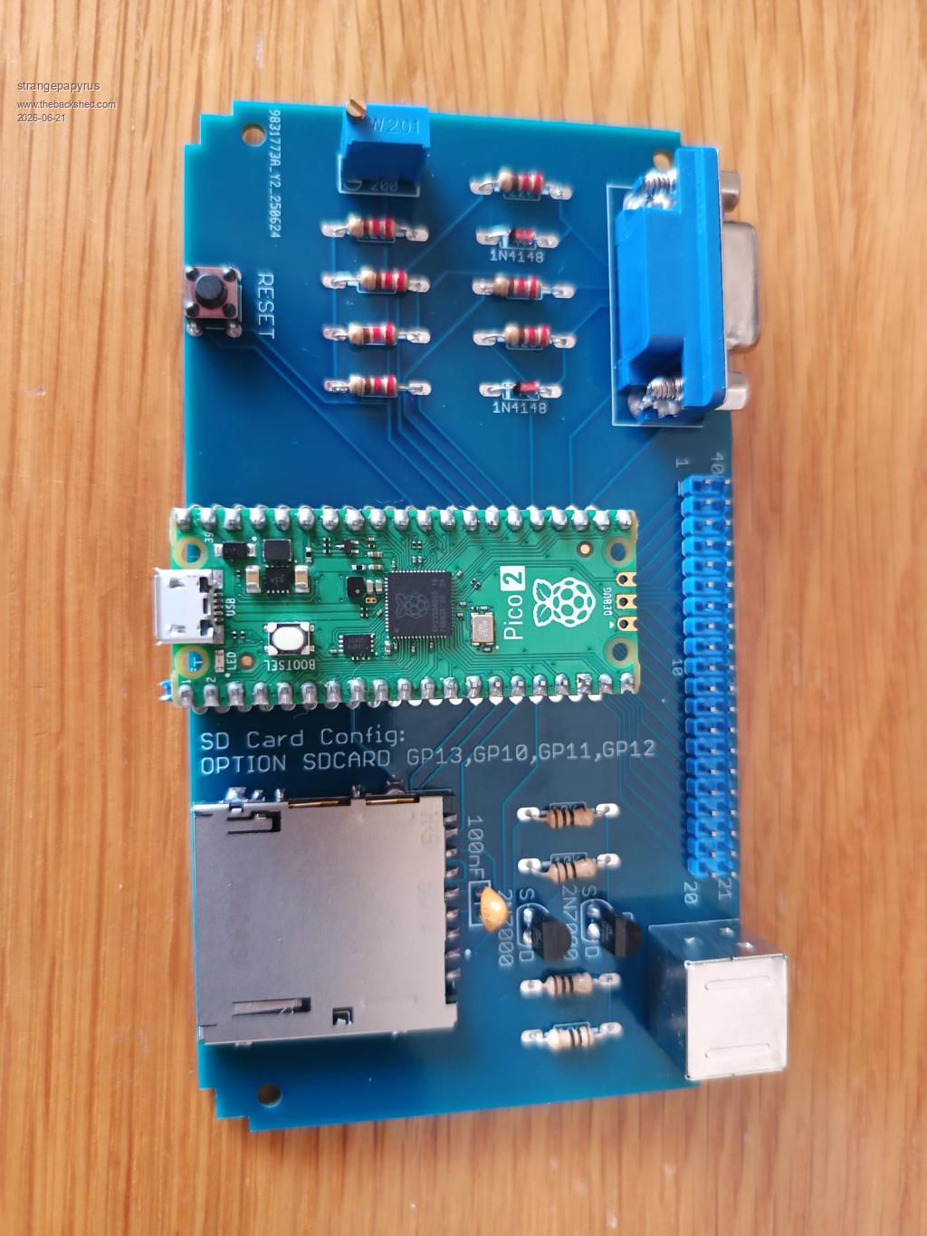

Hi,
Electronics is a fairly new hobby for me and this is my first post here. Please could anyone offer some advice to help me out? Thank you.
I decided to have a go a building the Picomite VGA and have been partially successful.
I ordered the PCBs to the UK from JLCPCB and the other parts sourced from various suppliers.

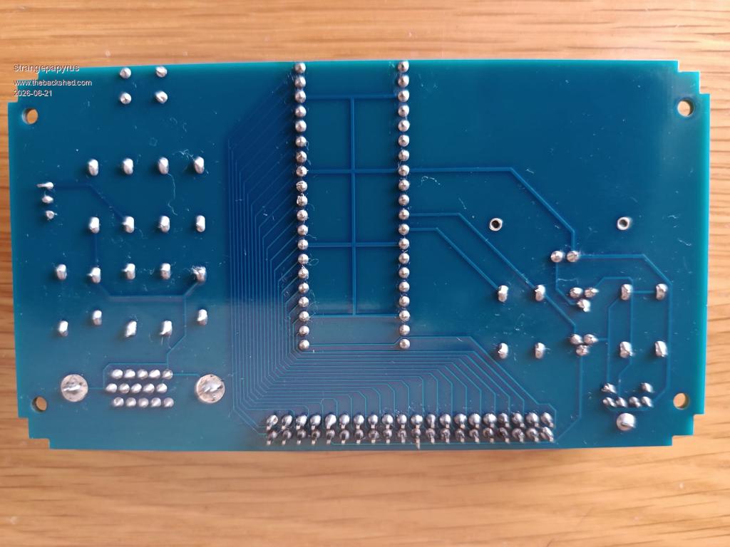

The VGA works, but not the keyboard. I have 5 volts out from the port so the MOSFET level shifting circuit must at least be partially working? The system boots, I can see all the post boot info on screen and a cursor, but absolutely nothing from the keyboard.
Thinking I must of done something wrong somewhere, I had a second board, so built a second picomite from scratch, including a second pico ....... and exactly the same. There does not seem to be power to the keyboards, apart from an initial flash of the leds on my Fujitsu keyboard at boot, CAPS LOCK, does not illuminate when pressed for example, and no output onscreen.
I have tried different keyboards. I have newer Fujitsu keyboards (x2) and an older Compaq keyboard (x1) - all PS2 wired, no adapters. I have tried soldering on different PS2 ports and different MOSFETS from different suppliers. I've tested the resistors and all seem good. I've tested the output from the PS2 port. I've tried newer and older firmwares. I've swapped the picos around and all to no avail.
The power supply is one I used to use on a raspberry pi, 5V 3000mA output.
I am starting to lean towards the PCBs being bad as I'm a bit stuck as to what's going on, so if anyone could offer any advice I'd be extremely grateful.

what are the colour bands on the four resistors near the 2N7000 transistors? from the photo they appear to be brown-black-black-gold, which would indicate a value of 10 ohms each. they should be 10,000 ohms each, which are instead coded as brown-black-orange-gold (the gold indicates 5% tolerance parts, which is unimportant).

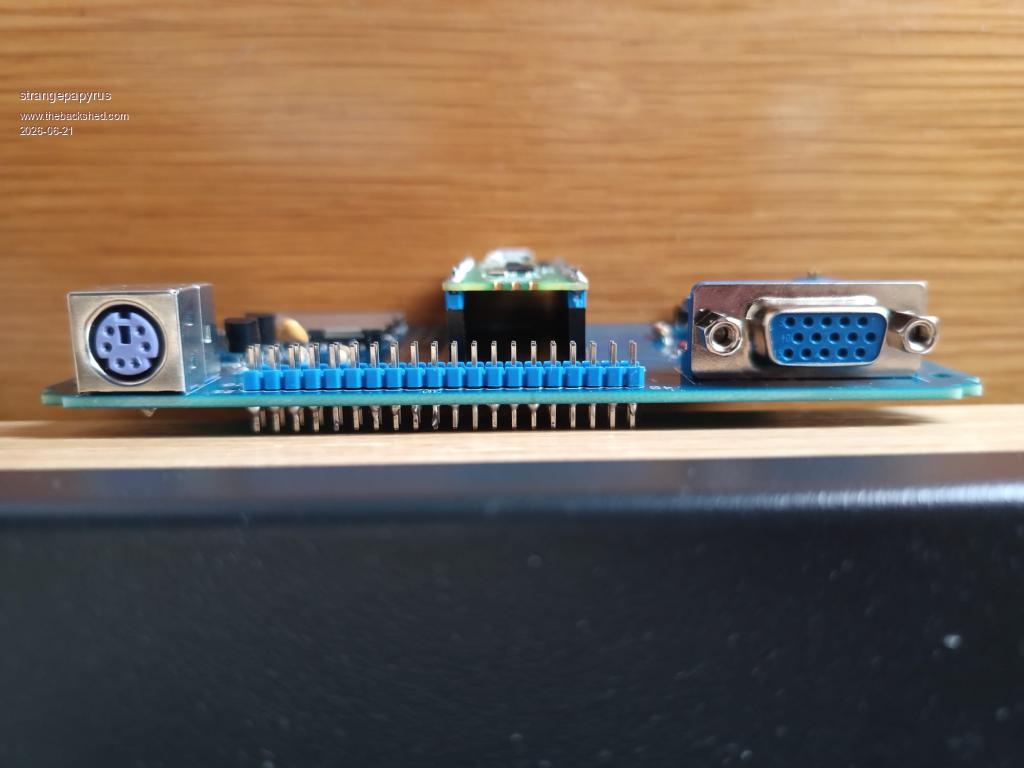

you do appear to have inserted the 40-pin blue header (located between the keyboard and VGA sockets) with the long ends of the pins the wrong way round, but this does not matter too much at the moment. otherwise, you have done a very nice job of the assembly and soldering

Rather than trying to de-solder the entire header it may be possible to push the pins through one at a time.
With the board upside down on a firm surface re-melt the solder and press down to 1mm above the PCB. The blunt end of a skewer, or better still a carpenters panel-pin punch should do the job.
As Rob said they do look like 10Ω resistors. If so that could damage the Pico if powered up for long. I think Peter has set 8mA current limits for the pins but it will still be heating the chip.

Oh my goodness. What a plonker. I need better glasses and missed that K in the list of parts in the design construction notes.
I have indeed put 10 rather than 10,000 ohm resistors in!

It will be hard to undo now, but from the photo's it looks like the 40 pin connector is placed upside down. The short pins should be soldered in the PCB. The long side connects to dupont wires, or connectors.

easiest solution - once the keyboard issue has been sorted out - would be to first trim the excess length off the pins on the underside of the PCB, then simply lever off the blue 20x2 plastic part using a small flatblade screwdriver, no heat required. the exposed pin length on top (with the plastic removed) should just about be sufficient to plug on dupont/berg connectors.
the downside to this approach is that if you ever want to resolder one or more of the pins, there will be nothing holding them all in alignment.
