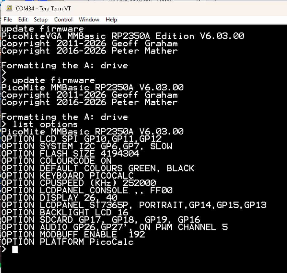

this version doesn't start up every time on my PicoCalc; it takes a long time to boot and then displays the following message:
Invalid clock speed - reset to default
In addition, you hear a "pop" through the speaker every time a launch is successful.
That wasn't the case with version PicoMiteRP2350V6.03.00RC26 - everything was fine back then...
Frank

Do the following, if this doesn't work I'm beginning to suspect your PicoCalc is on the way out.
Load PicoMiteRP2350VGAV6.03.00.uf2
You should see it boot up as follows: then reload PicoMiteRP2350V6.03.00.uf2 and it should immediately re-confiure for the PicoCalc

On this PC, the terminal only works through the USB-C port. And that port isn't enabled by default yet.
Okay, I loaded universal_flash_nuke.uf2, then the USB version, and then the regular version.
I had to restart PicoCalc twice, then I saw the message "Formatting the A: drive," and when I entered "OPTION LIST", "OPTION PLATFORM PicoCalc" was displayed.
After a restart, the following message appeared again:
Frank
