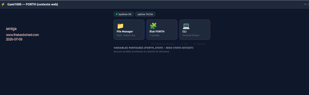

A small board that runs several independent FORTH programs at the same
time, each in its own sandboxed "context" (one drives the touchscreen, one
runs a built-in web server that doubles as a code editor and dashboard,
and you can spin up as many background contexts as you want for sensor
polling, MQTT handling, etc.). Contexts never share memory directly --
they either react to events (an MQTT message, a timer) or exchange data
through a small locked key/value table. Nothing exotic conceptually, but
it turned out to matter a lot once things ran in parallel for real.

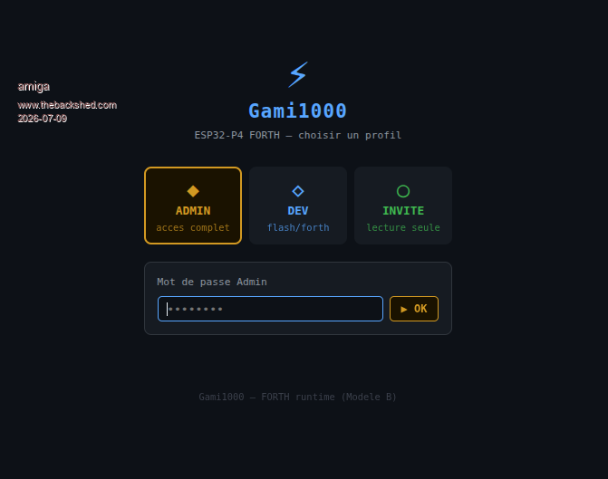

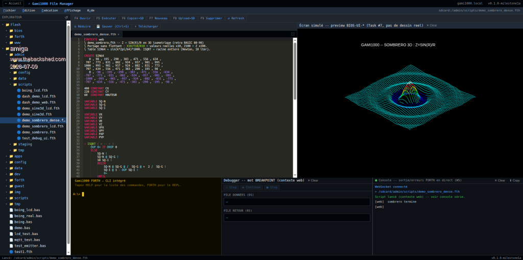

There's a full web-based IDE built in: code editor with FORTH syntax
highlighting, a DOS-style CLI, a step-by-step debugger with breakpoints,
and a simulated screen in the browser so you can test drawing code without
touching the real hardware at all.

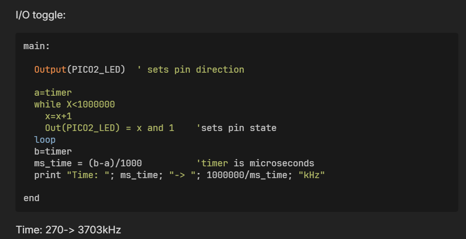

It is a very interesting project and might give it a go if learning new stuff wasn't so hard now. Even the new features of MMBasic have left me behind.
As Volhout said the PicoMite is reasonably fast.
Pico RP2040 @ 378MHz reading a pin.
> clear : dim integer n, x(9999) : setpin 1, din
> t=timer:for n=0 to 9999:x(n)=pin(1):next:? (timer-t)/10;"uS/loop"
13.2169uS/loop
Pico 2 VGA @ 378MHz
> clear : dim integer n, x(9999) : setpin 1, din :t=timer:for n=0 to 9999:x(n)=pin(1):next:? (timer-t)/10;"uS/loop"
8.6994uS/loop

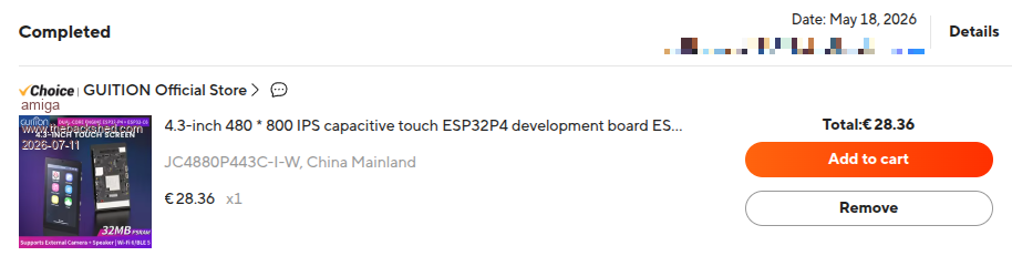

my first idea was to adapt MMBASIC to ESP32 family (use for a lot application : WIFI embedded in the silicum is a great enhancement )
But too complexe to adapt to ESP32.
I found another interpreter 'MY-BASIC' .
And the new chip from espressif 'ESP32-P4' is really a beast
With 2D engine,mipi,16MB spram,32MB flash but no wifi (i use a coprocessor ESP32-C6 (wifi,bluetooth and zigbee !).
On aliexpress i found a board with LCD mipi(800*400) +P4+C+ for 28€ .
It would be really interesting if someone or a group—looked into porting 'MMBASIC' to this processor. I’m talking about source-level compatibility, though obviously adapted to the hardware, since the processor handles all graphics, sound, and floating-point calculations—not to mention the 16MB of SRAM and 32MB of flash integrated into the ESP32-P4. Plus, the cost of the boards is negligible compared to their capabilities.
