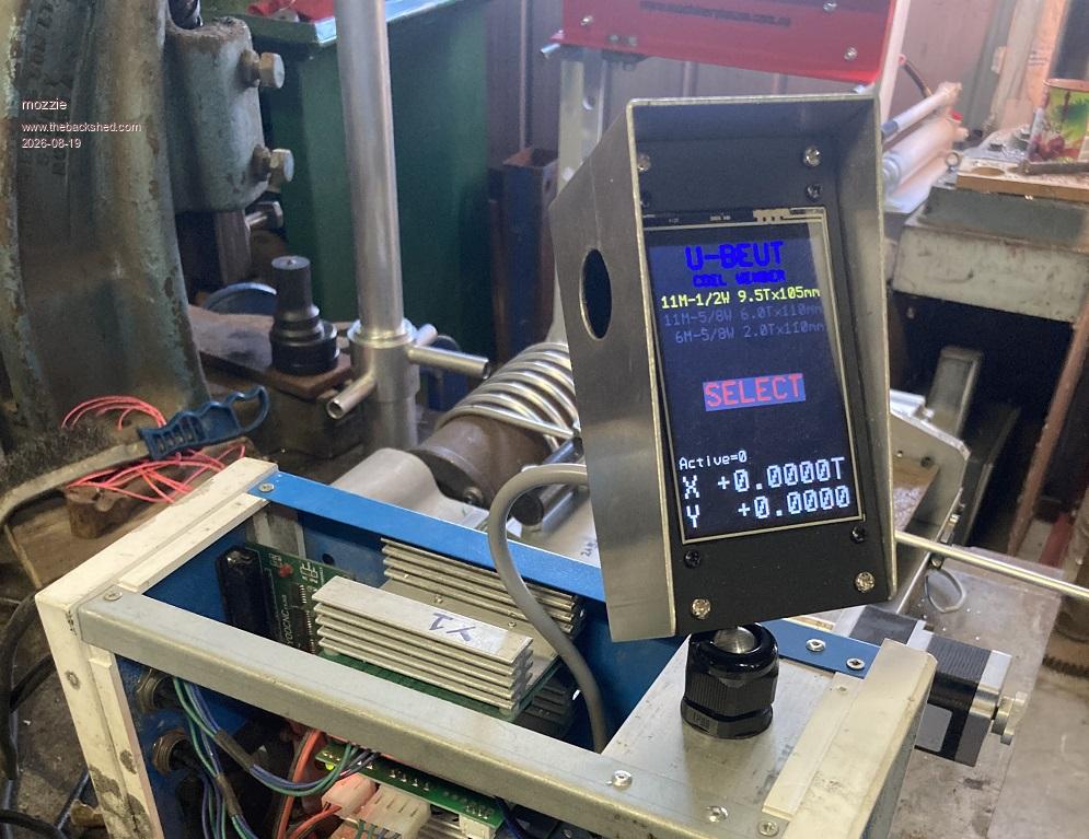

Phenix,
Any chance I could mis-direct the postage on those 2 CNC's down under    Extremely Jealous
Noise is indeed a major concern with stepper motor drives on CNC machines, a lot of the low end / hobby gear uses non screened cabling for the drives and the current control is often chopper driven so VERY noisy.
The idea with the Dual-Pico-CNC is to keep the CNC pico close to the drives and the wiring as short as possible, and have the HMI pico opto isolated and remote.
Even the setup below gave me grief until a 2.5mm earth was connected from the machine to the control box (with the lid on)
Lucky enough to have a manual guilotine and folder, makes this kind of thing a piece of cake.
Will be very interested to see what you build.
