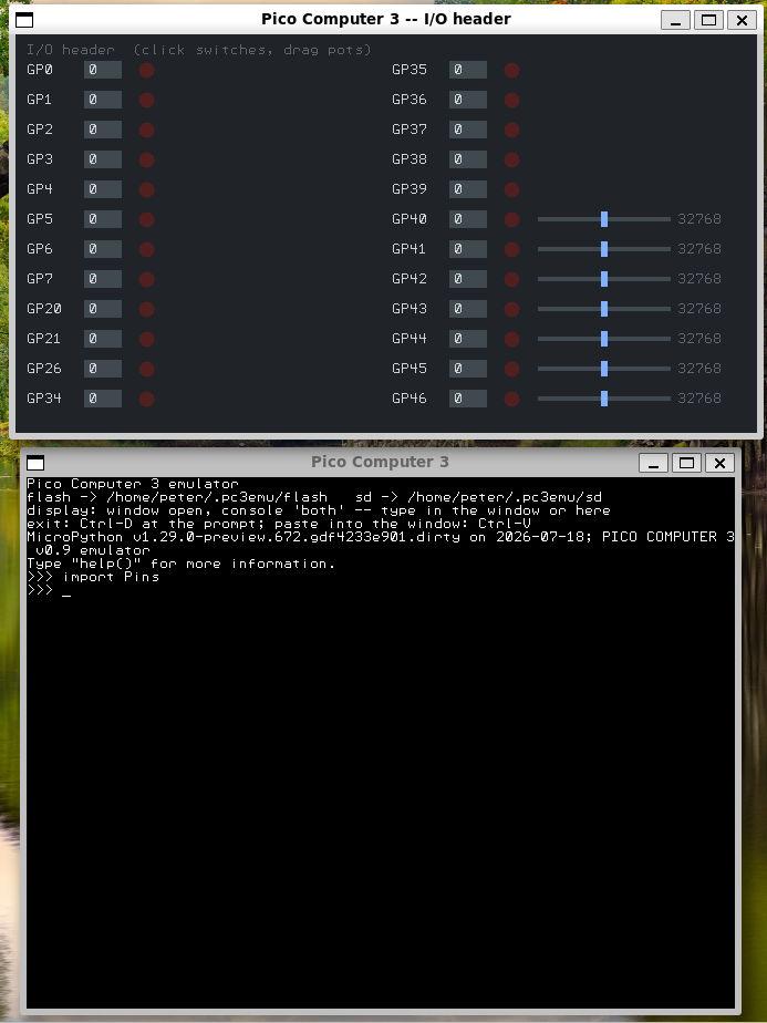

A full function emulator is now available for Micropython on the Pico Computer 3
https://github.com/UKTailwind/micropython/releases/latest
This is a Linux application but full details are included for installing it to run under WSL on a windows computer.
The emulator has exactly the same functionality as the real thing including video modes and audio other than the ability to physically control pins. However, if you "import Pins" in a program you will get a I/O panel so you can even test the basic I/O.

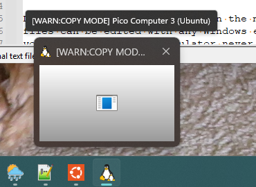

Posts: 6626
Posted: 06:51am 19 Jul 2026
If you are running Oracle Virtualbox, turning on Hyper V is likely to cause grief.
There are ways to run both systems but for now, I will look at installing the code on my virtualbox Linux instead.
That might solve my other issue:
I am unable to get anything other than the minimised view
The console functions OK but no display.
