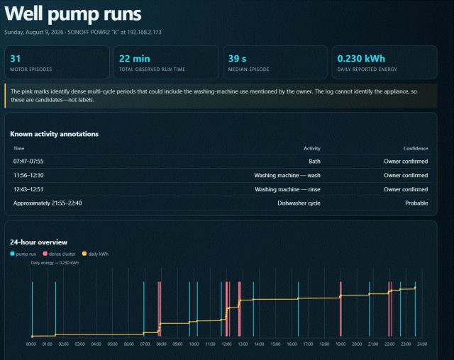

I then asked it to graph usage on the day with the most cycles. This is what it came up with:
Beautiful. I told it that the 8am runs were a bath, the 2 periods near noon were washing machine fill and then rinse, and the 10pm one, the dishwasher. On several other days I pointed out periods of watering the garden.
Based on these examples, I asked it to develop a python program to detect unusual runs--possible leaks slow or fast--and send me a warning email and SMS message. It did all of this, testing scenarios, without my further intervention. I then added a crontab line run this every minute, and set up tests confirming that I got the email and SMS message.

  Quote  Today, August 18, 2026, I:
 - Established serial access to the Dockstar through COM4 at 115200 8N1.
 - Confirmed it runs OpenWrt/Linux 5.10.176 at 192.168.2.70.
 - Inspected its sensor receivers, logging programs, crontab, processes, and recent data files.
 I mapped the sensor data flow:
 - TCP 8086 → listener2.lua → signals.txt
 - UDP 46225 → udp46225.py → signals.txt, then forwarded to 192.168.2.65:8086
 - UDP 39191 → udp39191.py → panels.txt
 - HTTP 8002 → receiver.py → Rx02.txt and signals.txt
 - poller.py polls four Tasmota devices every three seconds and records transition events in KLMT.txt
 I identified current temperatures for sensors A, B, C, D, G, H, J, and Y, including their last valid change times.
 For well-pump sensor K at 192.168.2.173, I reconstructed:
 - 947 complete episodes from June 22 through August 18
 - 498 episodes in the latest 30-day period
 - Median run duration of 36 seconds
 - Normal stable power around 970 W
 - Recent median of 15 episodes per day
 - Historical maximum of 31 episodes in one day
 - Longest observed motor run of 72 seconds
 - No evidence of sustained multi-minute operation or regular all-night leak cycling
 I analyzed August 9, the highest-use day, and created:
 - C:/dl/micromite_picomite_claco/chat/pump_runs_2026-08-09.html
 - C:/dl/micromite_picomite_claco/chat/water_cycle_annotations.csv
 Known or probable annotations include:
 - Morning bath
 - Washing-machine wash phase
 - Washing-machine rinse phase
 - Probable dishwasher cycle
 - Garden-watering events
 I developed and installed the water-leak detector:
 - Local source: C:/dl/micromite_picomite_claco/chat/leak_detector.py
 - Dockstar installation: /home/user0/leak_detector.py
 - State: /home/user0/leak_detector_state.json
 - Log: /home/user0/leak_detector.log
 - AWAY flag: /home/user0/leak_detector_away
 It detects:
 - Continuous runs over 120 seconds
 - Urgent continuous runs over five minutes
 - Seven starts in 30 minutes
 - Ten starts in one hour
 - Dense or persistent overnight cycling
 - Activity during four consecutive overnight hours
 - Unusually high daily episode counts
 - Recovery after suspicious activity stops
 It also sends a daily email summary around 07:05. Urgent warnings use both email and SMS, with duplicate suppression and recovery notifications.
 I added AWAY mode. When enabled, every newly completed pump episode sends email and SMS containing:
 - Run duration
 - Representative running wattage
 - Start time
 - Time since the previous pump episode
 AWAY mode was designed to arm at the current end of the log, preventing an old episode from being mistaken for a new one.
 Testing included:
 - Python syntax and file-integrity checks
 - Historical normal-use and washing-machine tests
 - Synthetic rapid-leak, continuous-run, and slow-overnight-leak tests
 - Production-mode state handling
 - Live AWAY-mode email and SMS delivery
 You added the once-per-minute crontab trigger. The live test successfully produced individual AWAY notifications and an appropriate leak warning during the washing-machine cycles. You have since returned the AWAY flag to false.
