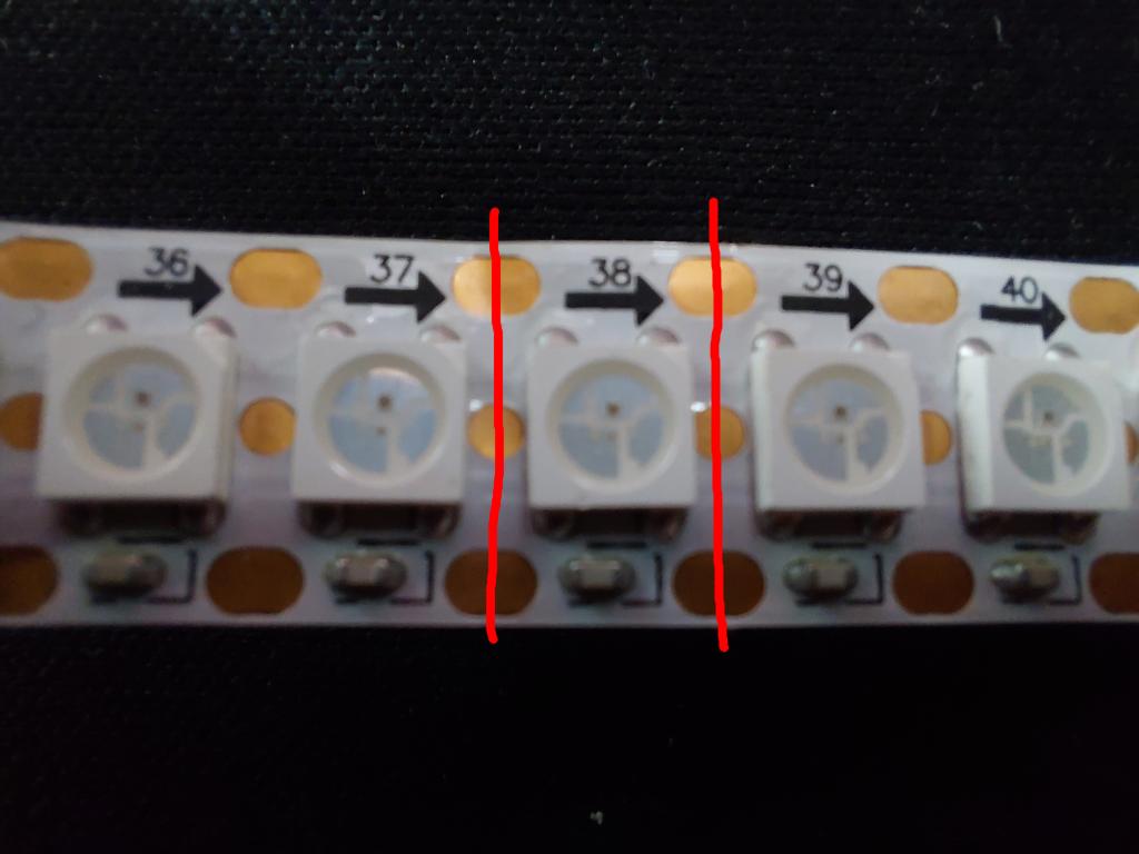

I want to separate out a 144LED/m strip into some separate LEDs.
From the image say I want to separate off LED 38.
So I cut as indicated and add wires to rejoin it - all OK.
I'm a little lost over the 5V and Ground -- am assuming that DIN/DOUT is the centre pin.
From what I find online I think GND is the pin nearest the 38 following the arrows
5V is the side with the resistor.
Secondary question:  the order of LEDS doesnt matter right?  As long as they are connected in parallel and in one "line".  The numbers on the strip are just for identification?

My guess (based on similar strips)
Top is 0V
middle is Data I/O
bottom is 5V
Each LED is the same. The numbers are just to make it easier to count.
Some strips run on 3.3V data others require the full 5V
If your strip has leads, you could apply power to the most logical colours and measure on the strip.
Alternatively, test the pins for continuity.
The data pins should stand out.
Edited 2026-08-19 07:26 by TassyJim

Nimue,
Unfortunately, I don't have enough information about this strip, and there are many varieties in circulation.
Is there any further information on the back, the ends, or perhaps where you bought it?
If we are talking about the WS2812 (5V) here, it might work with the existing firmware, but if you have a different type, I can't say for sure. There is also the WS2812B for 3.3V.
I saw a similar image on AliExpress showing a 7.2mm 3535 DC5V 144 LEDs/m strip.
On that strip, the arrow indicates GND, the capacitor's position marks the positive terminal, the middle-left pin is DI, and the right pin is DO—but I don't know if that is the specific type you have or if it works with the firmware.
On other types, the labels GND, DI, DO, and 5V are clearly marked on the strip.
Also, be careful with the pins on the PicoMite. Not all pins are 5V-tolerant—especially on the RP2040—though that applies to inputs; inserting a diode on the output might be a solution, though I’m not sure if that would work.
Jan.
