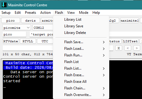

All flash commands are moved from the file manager to the MMCC menu. (Drive A: is still accessed through the file manager.)
Delete Library and delete all flash slots ask for confirmation.

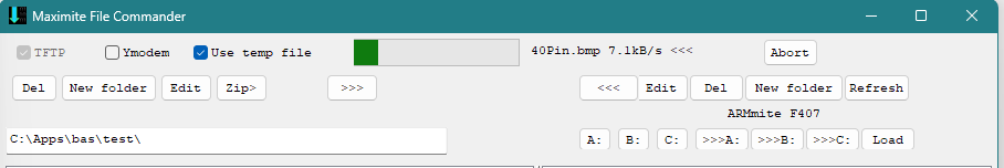

The top line:
TFTP is available on the webmite when connected via TCPIP.
Ymodem is available on some picomite variants. IF Ymodem fails to start, it will revert to Xmodem.
(TFTP and Ymodem are both much faster than Xmodem)
When transferring to a 'mite, you can choose to create a temporary file first. This is more secure and less likely to delete a valid file if the transfer fails. It does require sufficient drive space.
Transfers TO the PC always use a temporary file.
Progress indicator. It may not appear for small files. It resets to zero once the transfer is complete
File name and transfer speed followed by a direction indicator.
Abort lets you interrupt a transfer. If you have temporary file selected, nothing is lost.
No change to the second line.
Next is the device currently connected to as shown by MM.Device$
Below that are 3 "Change to drive" and 3 "copy to Drive"
It is the users responsibility to know how many drive their device supports.

Hi Jim,
Are the "change to drive" and "copy to drive" buttons for local copy ? (i.e. from picomite A: drive to picomite B: drive )?

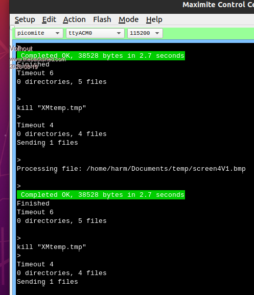

Small bug in MMCC: when transferring a file from PC to pico, using "temporary file".
When that file already exists (overwriting): everything is okay.
When that file did not previously exist(a new file): the renaming fails, and a file called XMtemp.tmp is left on the pico.
Edited 2026-08-19 17:00 by Volhout

  Volhout said  Hi Jim,
Yes Drive X to drive Y on the picomite.
There were buttons for drive A and drive B previously. I was hiding the ones that weren't relevant.
With the much larger range of devices out there, had to let the user work out which drives he has.

  Quote  Small bug in MMCC: when transferring a file from PC to pico, using "temporary file".
What sort of picomite?
I have tested with a picomite geek V6.3.0 and it transfers a new file correctly on both drive a and b
Pseudo code
KILL "fname$" ' will give an error message if it doesn't exist but doesn't stop things.
RENAME "XMtemp.tmp" AS "fname$" ' try the first version of rename command
NAME "XMtemp.tmp" AS "fname$" 'try alternatinve command to rename
Edited 2026-08-19 17:21 by TassyJim

Hi Jim,
PicoMiteVGA V6.03.00
On the MMCC there is no error message, but on the VGA screen it is something like
XMODEM RECEIVE "filename.ext"
KILL "filename.ext"
Error: could not find the file
Visible for 0.1 seconds, then immediately the VGA screen shows the result of a FILES command (the directory listing).
There is no RENAME and NAME on the VGA screen.
In the directory listing is XMtemp.tmp.
The behaviour is independent on file size (tested 4k...500k) or file name (also tried 4 character extensions like ".flac").
On MMCC screen there is a timout message that I cannot relate.
Edited 2026-08-19 18:49 by Volhout

@Volhout,
I wish I could work out what the difference is between our setups.
It would make finding the errors you are getting much easier.
You can ignore the Timeout error message. It is a loop counter when waiting for a response. When the number approaches 100, I know there is a problem.
I have added a few delays and now only use the temporary file when the target exists.
That won't find the reason for the error but it should get around it.
