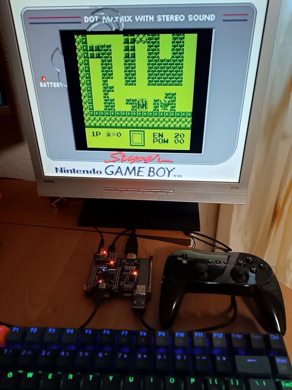

Nintendo GAME BOY & GAME BOY COLOR emulator for the PC3
PC3-PicoPeanutGB_012.zip
Video output: DVI or HDMI
Sound output: I2S or HDMI
Controls: USB keyboard or USB Gamepads, Wii classic controller,
two NES/SNES controllers
GP0 - CLOCK 1
GP1 - LATCH 1
GP2 - DATA  1
GP3 - CLOCK 2
GP4 - LATCH 2
GP5 - DATA  2
See the project's GitHub page for more information

  Martin H. said  I notice that here, just like with the NES emulator, an RP2040 seems to be enough.
Isn't it a bit wasteful to use the PC3 for this?
Hi Martin,
Of course, all these emulators worked on the RP2040, even with HDMI audio.
However, with RP2350 + PSRAM, NES game images are loaded not into flash memory, but instantly into RAM.
As for the PC3 platform, I built it on a breadboard, and now I have something to play with. So, it's just for fun.

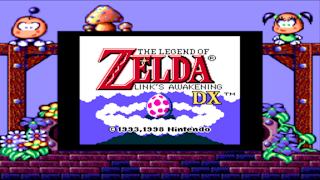

PicoPeanutGB is a Game Boy (DMG) and Game Boy Color emulator for PC3
PicoPeanutGB_v13.zip
v0.13 Release notes
A maintenance release. It brings the shared menu and support code up to date; the emulator itself is unchanged. Upgrading is only a matter of flashing the new .uf2 — your settings, saves and save states on the SD card are untouched.
Fixes
DVI-only monitors show a picture again. With Display Mode set to DVI, some older screens that accept DVI but not HDMI stayed black. They work again.
Clone Pico boards no longer crash at start-up. Boards fitted with a cheaper flash chip than a genuine Raspberry Pi Pico could hang on power-on. The chip is now recognised and driven at a speed it can handle. Genuine Picos are unaffected.
Steadier start-up. The board lets its power settle before switching to the higher clock speed.
https://github.com/PicoPlus-devel/pico-peanutGB
Posts: 6195
Posted: 02:30pm 16 Sep 2026
The RP2040 can only run the old monochrome GB games.
For color you need the 2350.
