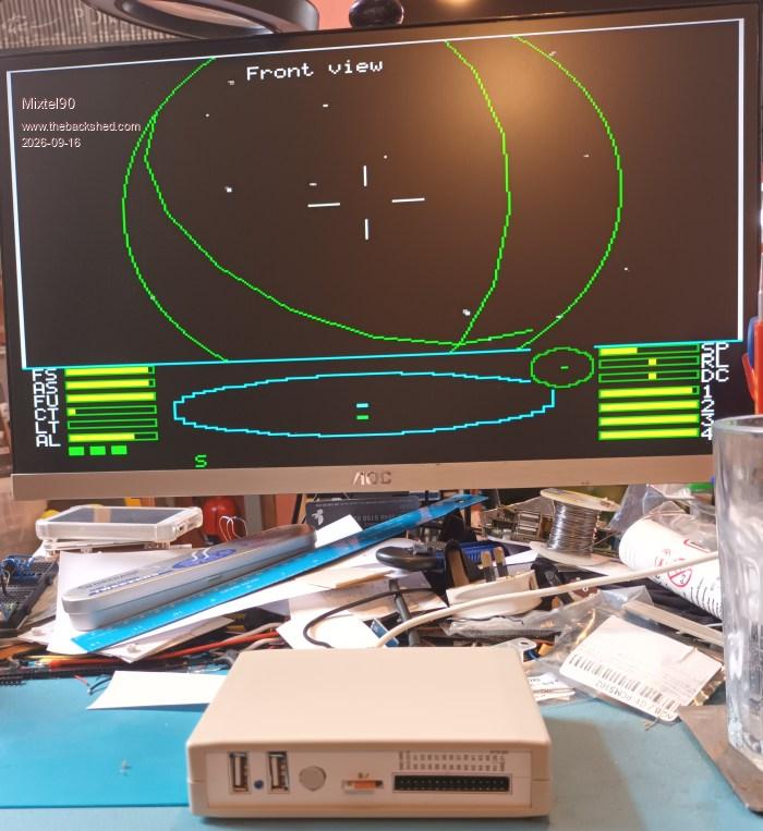

Yes, my prototype (with cardboard front and back panels) will run Elite just fine.  :)

Nice Mick !!!
If you hadn't told me I would not have guessed it was cardboard front.

I'm hoping to eventually learn how to 3D print the panels for my prototypes. Not the RM2015 boxes though, the mini printer that I've only just got only has a bed size of 120mm x 120mm. It's so new (to me - it's second or third hand) that I've yet to do my first print of any sort, never mind create a STL file for anything. :) Give it time - it only arrived yesterday. :)
I did the cardboard panels to test the drawings that I included in the manual - and they are very close. Possible improvements:
Open up the power button hole by about 1mm.
Move the micro SD card slot about 1mm to the left.
I need to investigate how the second error has happened. I have a feeling that my block of the module might be inaccurate. The button hole is simply a case of not allowing enough clearance, I think.

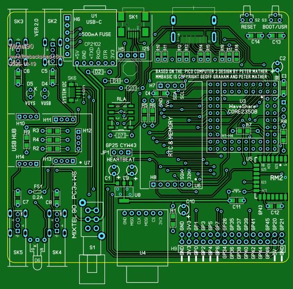

A lot of minor updates: PC3xWS Version 2
This uses the WaveShare CORE2350B which I ordered from AliExoress. This is one of the cheapest sources for this chip. You can get it with zero, 2GB, 4GB or 8GB of PSRAM. You CAN'T use the Pimoroni PGA2350 or any direct clones of it.
I intend to get some boards and check the design before issuing the gerbers, but if anyone wants to take the risk...  I've checked the design pretty well in SL6 so I don't *think* there are any nasties but you can always miss something.
* PROG connector changed from micro USB to mini USB to save board space.
* Powering via PROG automatically changes over from hub to PROG USB using relay and changes LED to red.
* You can now either directly mount HDMI socket and 0805 resistors or use Adafruit module, your choice. If you use the module you will need to bolt it to the board and use spacers as there are protruding lugs underneath it.
* Apart from HDMI resistors, all resistors and small capacitors can be either SMD 1206 or through-hole, your choice.
* RESET and BOOT/USR buttons on rear.
* There is space for a ferrite bead in the 3V3 supply to the RM2 as well as an additional capacitor just before it.
* Power chain changed to make it more sensible.

Mick,
This is for the RM2015 case. Are there mounting holes ?
There was an issue with wifi sensitiviteit and ferrite in the 3v3 line to the rif module ? Did you add that filter?
U8 might get warm. Cooling?
Fuse for 5v for the usb hub, but not for 3v3 and 5v on the GPIO header?
Where is the sound chip?
Edited 2026-10-19 02:58 by Volhout

The mounting holes are invisible here because they have a pad on the bottom layer, which is switched off. :) Yes, it fits the same case but with different panel layouts.
There is a CLC filter using 1uF (C11), a ferrite bead and 100nF (C12). The GND is solid on both top and bottom copper fills.
Just beneath the body of U8 there are 4 vias that link the top and bottom layers. These should help conduct heat through to give me copper area both top and bottom. I did originally have an isolated area on the bottom with vias through the tab of U8 but I changed my mind. It will be dropping 1V7 and does not feed the MCU, only USB and GPIO. Also, the main conductor from the pad is 0.6mm wide and will conduct quite a bit of heat away.
The USB-C module includes a 500mA fuse (which I assume is self resetting). That is the maximum allowable load from a USB-A port on a PC. I fused down the USB hub so that there will be some discrimination with it and shorting a USB shouldn't crash the CPU. Self reset "fuses" are a joke anyway. That's the continuous carry current, not the tripping current. :) There is no other protection for the GPIO 5V and its 3V3 is depending on U8, which is also effectively limited to the same 500mA at which point it will dissipate about 850mW.
There is a I2S sound module mounted upside down and plugged into H5 and H6 over the top of the USB-C and PROG sockets. It has its own 3.5mm jack. The hexagon immediately behind it is a spacer screwed to the board to take strain off the connections as a plug is pushed in.

Posted: 03:03pm 20 Oct 2026
Slight changes. Almost there now.
Restored the heatsink areas for U8.
Added fuses for the 3V3 and 5V supplies to the GPIO port. Both 0.2A like the USB. All fuses can be through-hole or SMD.
Added 10mA standing load to the output of U8 to keep it regulating.
It's passed DRC and visual tests.
Schematic is just about ready.
Confirmed that the USB-C/UART module does indeed have a 500mA self resetting fuse.
Need to sort out the changes to the manual and BOM.
Incidentally, a 200mA self resetting fuse starts to trip at 400ma. Its resistance then increases and the current falls until it is passing 200mA. Similarly the 500mA fuse starts to trip at 1A. In the tripped state the temperature of these fuses can go up to about 125°C. You don't want to touch them accidentally. They are also very slow to operate so are not great protection against anything other than a severe overload. You can expect this board to be capable of passing up to about 5A from the incoming supply to a GPIO pin for up to about 5 mins. It'd be interesting to test that and see what survives. :)

I was tweaking again last night and I think I've managed to get the RM2 fully onto the board now, rather than poking out over the side. Range may be slightly less but there's less chance of damage and the board should now fit any case that the Pico Computer 3 will, subject to changed front and rear panels.

If the RM2 is now not sticking out, just make sure there are no tracks or copper under the antenna area and all will work perfectly
Posts: 9287
Posted: 08:28am 21 Oct 2026
I've managed that. No copper or tracks on either side.  :)
Just this minute added the options for a push-push micro SD card and 1206 LEDs. I'm trying to get it so that a lot can be surface mounted without losing through-hole options. It's not that easy! In some cases SMD is the only way. As they used to say at work, "Treat it as a design challenge" - but they didn't need to design it.
