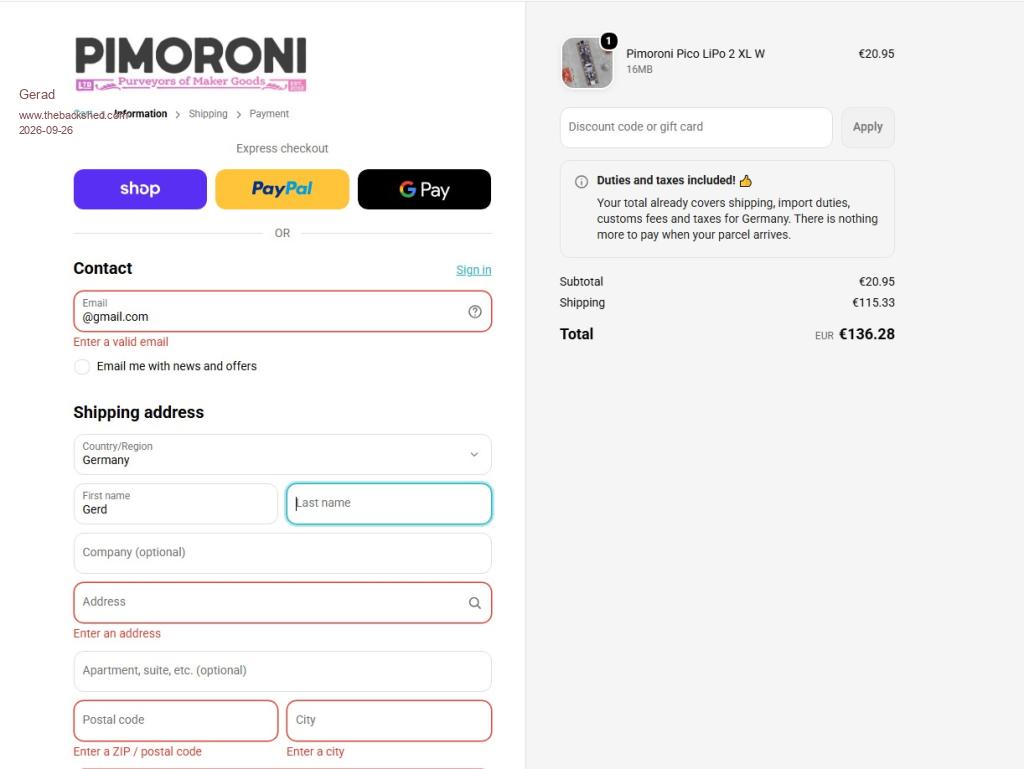

PIMORONI :
Because of the crazy prices, I had to cancel my order

Gerad,
I can't believe the shipping cost. I had 2 "pico plus 2W" plus some other minor stuff delivered about 4 weeks ago to Austria. The shipping was about 27€ IIRC. The cost for shipping to germany should be essentially the same. There was an additional bill from the shipping company of abt 10€ for customs a few days later. Did use PayPal for settlement.
