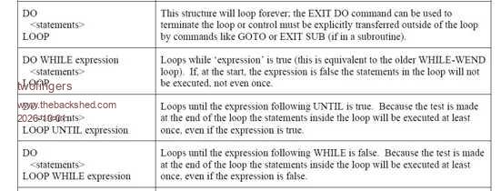

DO [WHILE / UNTIL ...], LOOP [WHILE / UNTIL ...]
    runs as text: a user FUNCTION call in the condition

twofingers
Joined: 02/06/2014
Posts: 1779
Posted: 09:09pm 30 Sep 2026
  matherp said  [...]
- The manual's command list was missing `DO UNTIL condition ... LOOP` and
 `LOOP WHILE`; both have always worked.
I must have overlooked this:
Although - I can't prove it - I seem to recall (for >v6) getting error messages with "Do Until" in some cases that made it necessary to replace it with "Do While Not" [...].
  Quote  Summary of changes from V6.02.01
All versions
Performance improvements for FOR/NEXT loops and IF/THEN/ELSE/ENDIF constructs
OPTION PROFILING ON/OFF 'see option-profiling-cache.pdf for details
The editor now supports editing long lines without splitting them or using continuation lines
DO UNTIL/LOOP now implemented
I'm pleased, but still skeptical ... Thanks for this useful addition!
