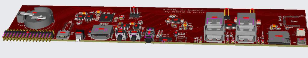

I thought it might be fun to re-do the Pico Computer 3 in a form that could be built into a keyboard. This is the identical circuit with the addition of an internal USB header, a 5V header, and a 3.3V header. I haven't built it but if anyone is interested I can post the gerbers. It passes all the design rule checks and as the circuit is the same it should just work.
The idea is that you could take a usb or bluetooth keyboard and with a bit of modification build this circuit into it. Everything you need is accessible along single edge of the board.
The board is 225x48mm

Posts: 12301
Posted: 11:19am 13 Oct 2026
height is identical to a normal PC3 which is the height of the USB connectors, just under 20mm from the biggest solder blob to the top of the usb connector

Posts: 9402
Posted: 12:11pm 13 Oct 2026
It takes up a lot more space along the back. A bit more than twice as much as using two doubles as you have to leave an extra gap. The double ones are about 15mm high from the surface of the PCB. A single horizontal sticks up a touch under 7mm.
For comparison the RTC battery holder sticks up about 8mm above the board and male pin headers around 9mm.

Posts: 12301
Posted: 01:48pm 13 Oct 2026
  Quote  the on/off switch between hdmi and usb-c ist not reachable for persons with not so thin fingers (on my pico 3 I use a toothpick).
There is 8mm more space around the switch on this layout.

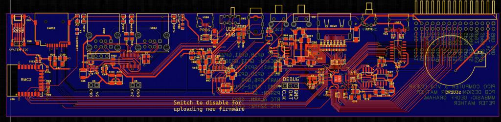

Posts: 12301
Posted: 11:53am 14 Oct 2026
Here are the design files. Use at your own risk. They should be correct in that the schematic is the same as the PC3 and the layout passes all design checks. I have ordered a couple myself. I leave off the through-hole parts and solder those myself to save a bit of money. JLC are currently out-of-stock of the CH340C but these are easy to acquire and solder. When ordering the BOM doesn't tick the programming USB as it needs special attention which costs an extra $0.30 so remember to tick it if you can stand the extra cost
PicoComputer3.3linearFiles.zip
The board is 225 x 48mm
The mounting holes are at 4,4  4,28  80,38  112.5,4  165,38  221,4  221,28
measured from the bottom left of the PCB as pictured
The location of the centres of the edge components are:
Qw/ST 4
SD 19.7
USB1 43.1
USB2 65.7
Prog/USB switch 87.1
Prog-USB 99.3
Audio 113.2
Reset switch 123.8
Boot switch 134.2
Power switch 165.4
HDMI 178.9
I/O 204.8
These measurements assume that the centres reported by the parts footprints are correct.

Posts: 12301
Posted: 12:25pm 19 Oct 2026
Boards have arrived and work perfectly. I'm working on an endplate to fit over the various connectors and then next steps will be to choose a keyboard and try to make it all work together
