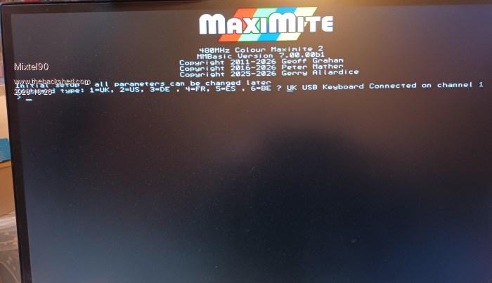

I attempted to update a Gen 1 Revision2? (the one with an SMD chip rather than the module) last night. It failed. The Busy light stays on solid. The display has no CRLF before the string of keyboard options. A prompt appears then all is dead. No keyboard response or anything. The battery was flat (I guess the 1220 always is!) so I took that out. Same result whether there is a SD card in or not. Tried powering from USB on the PC and from a USB power bank. The setup (power supplies, leads etc.) works fine when I run my original CMM2 (the one with the module) so it doesn't look like a power supply problem. I'll probably have another play later.

Yep, USB A-A cable and a newly downloaded STM Cube. The firmware unzipped ok, appeared to load ok and appeared to verify ok. The header comes up ok on the display so the system is running - or at least starting. There is no prompt for the time & date, even with no battery fitted, it doesn't get that far (or skips it).
The firmware is CMM2V7.00.00b3.bin size: 1107 KB

Posts: 9245
Posted: 03:23pm 25 Oct 2026
Tried V700.00.b1 and that failed in the same way.
Sequence:
No battery or SD card
Disconnect power lead (power switch off anyway)
Change link from RUN to PROGRAM
Connect to PC using USB A-A lead
Run Cube
Click Connect - get message that it's connected
Select Download section
Select file to use
Select Verify Programming
(Select Full chip erase -if using it)
Click Start Programming - get bargraph followed by "Successful" popup
Verify starts automatically - get "Successful" popup
Close popups and disconnect
Disconnect A-A lead
Plug keyboard into USB-A socket
Change link from PROGRAM to RUN
Connect power lead
Switch on
Run light on
Busy light after a delay (solid, not blinking)
(now I have a bit of a delay while the silly monitor will switch to VGA and stay there!)
Get rock solid VGA picture. The cursor is flashing but keyboard does nothing.

Posts: 12066
Posted: 03:52pm 25 Oct 2026
With that on the screen you should be able to press the 1 key. You will then be prompted for the time and date. Just type numbers. It does the rest. Ensure you have a battery installed before finishing the numbers. If that doesn't work try over teraterm
I've just been through the whole process on a g2 with no issues. Do a full chip erase to start just to be sure. After you have flashed it may be worth power cycling. Then with the battery out you get the keyboard prompt followed by the keyboard connect sometime after. Press 1. The I inserted the battery and entered the time and date. After that it rebooted an all good to go.

Posts: 9245
Posted: 04:21pm 25 Oct 2026
Yay! Thank you very much, Peter, things are working now. Have installed SD card, Phenix, and my only "rare as rocking horse pooh" platinum plated battery.
It had me fooled because there is a CRLF after the keyboard prompt question mark on 5.06 and it stops to wait for a digit to be pressed. This assumed a UK USB keyboard was connected. (it's actually a US keyboard by the way) In my dim way I assumed that if the USB keyboard had been recognised simply pressing return to accept it would lead to the date/time setting. I thought something was playing up. :)
