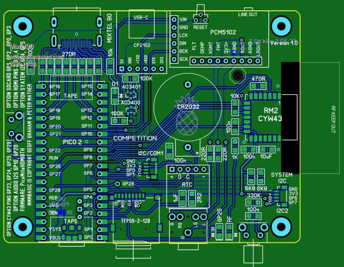

I assume this firmware is compatible with the OPTION CYW43 PINS system? I'm designing a new board that is based on bluetooth as it's main system but has the option of using Pico 2 + RM2, Pico 2W or Pimoroni Pico Plus 2 W. Obviously the Pico 2 (or clones) don't have the standard pins for a wi-fi module.

I couldn't think of a snappy name for this board so I'm open to suggestions!
Get your suggestions in before Friday 09:00 AM GMT. The winner gets to see their suggestion on the PCB and a free unpopulated board posted to them. Postage will be by international standard first class post.
Board details
Same size as Elemento but different fixing centres
Interesting power button circuit using mosfets
Virtually all SMD soldering (1206), including the HDMI connector (sorry, not much through-hole)
Will accept modules as listed in original post
module's USB connector accessible from front
I2S audio
mini RTC, with space for CR2032 holder
micro SD card
CP2102 module for USB-C and console connection
headphone socket on front (fed from I2S via resistors)
no space for GPIO as such, but GP28 on a pin and two QWIIC sockets, one on each I2C.
You will have a choice of either waiting until I have a prototype doing something or taking a risk. :)

Posts: 9260
Posted: 09:58am 28 Oct 2026
Now we know what it will almost certainly look like:
The fixing centres are the same as Elemento vertically but they are wider horizontally due to lack of PCB space. It might not be possible to get it into the original Elemento case due to projections front and rear, but it would fit the 3D printed version nicely, subject to the panels being modified (and me finally sorting the case out!).

Hi Mick,
So essentially this is a PC3 with the USB hub circuit external (standard 4 port hub with USB-C or microUSB connector connecting to the pico2 USB connector) and virtually no GPIO pins free (2350A).
And there is one SOT23 FET on the bottom side (VSYS ?)
Posts: 9260
Posted: 01:08pm 28 Oct 2026
Nope, this isn't a PC3. It's incompatible. To get compatibility you need a suitable RTC, GP27 and GP32 available as well as PSRAM. Obviously those pins aren't available on a 40-pin module. For a PC3=compatible modular build I did the PC3x, which gets as close as I can get.
This board is a little different and is more like Elemento. You can plug in (or solder in) any 40-pin RP2350-based module. Unlike Elemento you are stuck with HDMI for video though. It is specifically designed for the PicoMiteHDMIBTH firmware and is intended to use Bluetooth for keyboard, mouse etc. I2S is available if you prefer it to bluetooth audio (I think the audio quality is better).
USB is available if you want it. What looks like a SMD under the board is a solder blob link. If the board is powered via VSYS (the default to prevent a back-feed) then the USB socket is not powered. Swap the link over to power via VBUS to make the USB socket powered.
If you can get a Pimoroni Pico Plus 2 W or clone thereof then you can leave off the RM2, gain more flash and get PSRAM. It has to be plugged in.
A Pico 2W can be plugged in and the RM2 not used.
A Pico 2 can be soldered directly to the board and used with a RM2.
