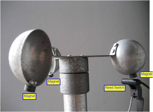

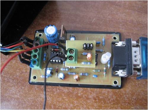

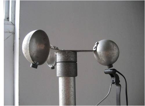

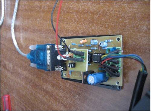

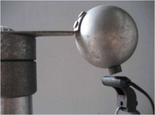

Hi There,
We bought 4 PicLog but somethow, none of them could read the RPM from the anemometer, we followed each step of the instructions in the link but it still doesn't work, here are some pictures, please kindly have a look and let me know what the problem is....
Your help and early response will be highly appreciated!!!

Cindy that circuit board is not the same as the one in the article. I would suggest you contact the person you bought it from for help.
Also note, the Piclog is open source, and can not be sold/resold without permission.

Hi cindy,
You checked to see if that magnet is able to turn on your reed switch? Your reed switch is in the right position? Your wires are ok?
You wrote the program inside the PICAXE, or it was delivered with the software in place? You tested the Piclog with the last software available on Glenn site?
Your Piclog is able to read input voltage values?

Hi, Vasi, thanks for your reply, here are the answers to your questions;
yes, the magnet is able to turn on the reed switch, the reed switch is in the right position. What do you mean if the wires are okay??? (we are not sure if we connect the wire correctly, can you tell from the above pictures)
It was delivered with the software in place. we tested the Piclog with the last software available on Glenn site.
My Piclog is able to read input voltage values.

Hi Cindy
The fact that its reading voltage OK means the PicLog and software are working. Unfortunately I'm not familiar with that circuit board, so dont know if its set up for a reed switch type of wind speed anemometer.
Maybe the time between magnets is too slow. The Piclog will count the pulses in one second, which works OK for small diameter anemometers with more than a couple of magnets. Have you tried spinning the anemometer really fast to see if there is a reading. Also, its not reading RPM, its the kmh reading that should be changing. The RPM reading it taken from the alternators AC output.
If you have a multimeter, set it to read volts, put the negative lead on the circuit boards 0v rail ( center pin or tab of the LM7805 regualtor ), and the positive lead on pin 5 of the PicAxe IC ( 8 pin chip ), see below
As you rotate the magnet past the reed switch, you should see the voltage on pin 5 change from 0 to 5 and back
Hope that helps.
