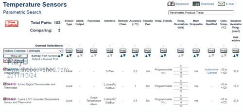

Surely 1WIRE was an omission from previous list or how else would we communicate to the likes of high accuracy DS18B20 which I see as essential.

Ray,
You could use a DS1721 (or equiv) I2C with 3 address pins giving 8 devices on 1 bus. I think very similar 12 bit resolution and 0.5 degree accuracy etc, same manufacturer. Sure you need to run a few more wires but 1WIRE requires a lot of software. I have just purchased 10 off for $5 total. My little boards are made and I do not expect it will take long for the software. They can live on the I2C string with my RTC to give me a great logging system to the SD card.
Keith W.

Hi Ray,
There has been meantion of I2C regarding Real Time Clocks (RTC) on the forum and in a few other places. I will post my DS1721 code when I have it working.I have implimented an I2C data transfer to a Picaxe to drive a 128 by 64 LCD display, also on the Forum. I obtained the DS1721 devices from Rockby Electronics. Currently on special in lots of 10 while they last, Rockby have other I2C temperature devices also. Download the data sheet from the web which contains a discussion of I2C. They use a slightly more complicated I2C protocol than other I2C chips but easier than 1Wire which uses convoluted addressing methods. The chips are 8 pins and small but I can now construct little boards at home using a method with a laser printer and hot ironing the resultant image onto the board as a resist, I have constructed an I2C RTC board already and posted the code.Having addresses set at individual boards will make keeping track of multiple thermometers positions much easier.
