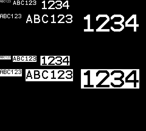

Inspired by the efforts of Gizmo and jman to draw large numbers I have put user selectable fonts into this new version of MMBasic. There are now three standard fonts:
- The basic font of 10 x 5 pixels.
- A larger font of 16 x 11 pixels.
- A jumbo font of 30 x 22 pixels consisting of the numbers zero to nine and the characters plus, minus, comma and full stop.
You can select between them with the FONT command. You can also scale a font to x2, x3, x4, etc in size and you can display the characters in reverse video.
The image shows all three fonts on the first line. The second shows all three but scaled by 2 (ie, doubled in size). The last 2 lines are the same as the first two but with reverse video selected.
You can also load up to seven of your own fonts from text files on the SD card. The characters in these user created fonts can be up to 64 pixels height by 255 pixels wide. A pdf included with the hex file describes the font commands and how to create your own fonts (it is easy - you use notepad).

Posts: 5198
Posted: 07:26am 22 Sep 2011
I've just loaded up the new version and stared changing the number readouts on my little RE controller/logger project. First font I tried was #3, looks great!
The LIST command is not working as expected. It seams to ignore the line-line parameters. My program has lines from 10 to 1000, LIST -400 does nothing, LIST 400- lists all lines, even those before 400. LIST 200-400 also list the entire program. Bug ( Glenn is wondering if he's missed a post about changes to the LIST command )

Drat, that was a result of my optimising some of the code.
This fixes that fault and a couple of related issues:
http://geoffg.net/Downloads/Maximite/Maximite_Update_V2.6B.z ip
Geoff

Posted: 08:29pm 22 Sep 2011
Hi Geoff,
Just having an issue with my maximite Version 2.6b:
This code:
10 FONT #3,2,1
20 print "hello"
print the hello in normal font and then puts the cursor 4 lines down.

Posted: 09:08pm 22 Sep 2011
Font #3 is numbers and select characters only. This had me going for a while too.
try
10 Font #3,2,1
20 print "0123456789+-,."
Cheers,
Anthony.

Hi Geoff,
I'm having a problem with version 2.6B. Maybe I'm not understanding the instructions, but....
If I type:
FONT #3,2,1
PRINT "0123"
I get normal characters on the screen. I should be able to do this from the command prompt, right?
Hmmm, apparently you CAN NOT use this from the prompt? Just tried it inside a short program and it works fine.
grumble, grumble.
BTW, the cursor stops flashing after I use the FONT command (in a programme)
Bob Devries
