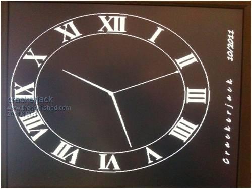

Hi All,
I really should get my teeth into some neat hardware oriented projects, but in the meanwhile I've been having yet more Maximite (BASIC software) fun.
The evergreen Analog Clock gets some treatment here... but really just as an example of what can be done using converted bitmaps as a background. See this post and this code for details on this.
Back to the clock...

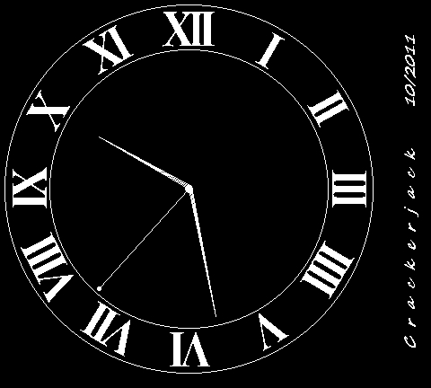

Photo of the VGA screen:
Screenshot using the SAVEBMP command:
The Maximite is never going to be an Apple-killing graphics work station, but some nice little effects can be obtained - and hey, it's so much fun...
I guess gauges and backgrounds of all sorts could be preloaded and then actual measured data displayed within the "blank" zones. jman's neat In-Car Console Display from a month or two back springs to mind as a perfect place to use this type of approach.
Code for the clock is zipped and available here including a "blank" bitmap of the Roman Numeral clock face. Checkout the Converted Bitmaps link above on how to convert bitmaps to a snappy format the Maximite likes.
Also, the minute- and hour-hand rendering code is far from perfect and leaves the pointers looking a touch "skinny" at certain times of the day. Easily fixed, but those hardware projects beckon...

For anybody interested, there is a small update to the code to make the clock behave more like a true analog clock:
- the hour and minute hands are now rendered in a uniform way regardless of their position on the face;
- the second hand extends beyond the clock center in both directions;
- the hour hand indexes according to the number of minutes passed in the hour - e.g. it would be halfway between 10 and 11 at 10:30 AM (not left pointing at 10 with a sudden "snap" to 11 as the hour passes).
Also there is an annoying tick-tock sound (which may be switched on/off at program start).
The math/trig is probably a bit cryptic in the code as it is not commented - but digging through it you will see a way of rendering rotary gauge-like pointers (or needles) of arbitrary "weight" or "thickness" as is done with the hour and minute hands.
The Maximite is quite a marvellous little beast - it only takes about 7 milliseconds to run the entire Time Display routine leaving about another 993 milliseconds of not doing much at all while we wait for time to pass...
