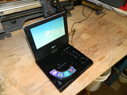

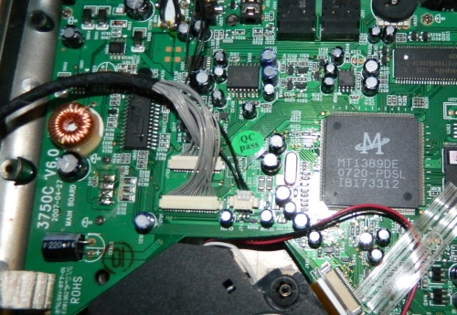

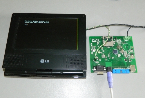

I dug up an old DVD player that was given to me because it stopped playing DVD's.
The display worked, so I opened it up to see if I could separate the screen from the rest of the unit. No luck, the video controller is part of the main circuit board.
But the unit does have a video input, so I wired in a cable to connect it to a SM1 Maximite set to PAL output. The screen swivels around and folds down, cool, but when I power it up, I need to press several buttons in sequence to select external video source, bummer. It will do for testing.

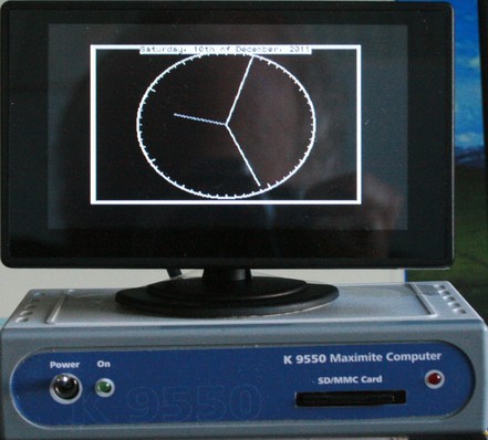

The MM SM1 from Dontronics, I don't see that it offers composite video output. Does that mean that the 4.3 TFT displays can't be used with the SM1's?
Could they perhaps be used with a VGA to composite convertor? How fuzzy would the image be? Does anyone have a clear screen shot of a MM screen full of text displaying on a 4.3" TFT?

I think I'll order up a 4.3" TFT. Does anyone happen to have a good quality screen shot of one hooked to a MM with a screen full of text? These 4.3" screens are on Ebay right now for as little as a 20x4 LCD, $20 USD. It might be nice to see just how readable they are though. The text should be very small on a 4.3" screen.

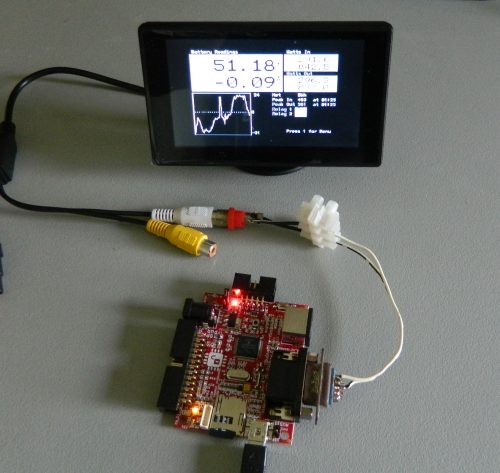

Posted: 03:14am 20 Dec 2011
The little LCD arived today, all the way from China.
Have to say, for the money, its pretty good! The unit has a few menu options, like brightness, contract, colour, and aspect ratio ( 16:9 or 4:3 ). Image clarity is good, though hard to see in the picture below.
