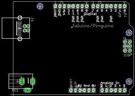

Duinomite needs an Eagle "prototyping" board (an empty board/project) for this area (including the screw?):
Also, apparently, there is more space for Arduino shield than on the original Arduino board but, if those connectors collide with the shield, then a proper empty Eagle shield is required:

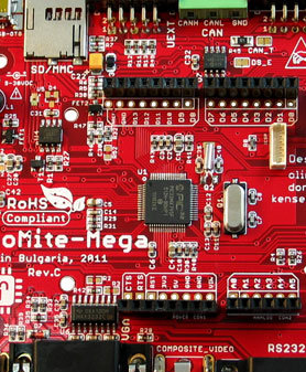

  vasi said   Duinomite needs an Eagle "prototyping" board (an empty board/project) for this area (including the screw?):
Hi Vasi,
Not exactly sure about your question, but that section is for an INTERNAL UEXT pcb, For example a blue tooth or wireless board that is small and can be mounted internally to the case and still leave the external UEXT socket for other peripheral, as in the MOD-IO board or any others..

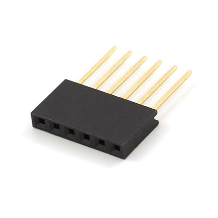

If you are talking about a physical clash of a particular Arduino shield and the DM then of course simple header pins can be installed to raise the shield slightly to provide clearance, as in these type of pins...
Olimex
Joined: 02/10/2011
Location: Bulgaria
Posts: 226
Posted: 06:54am 15 Dec 2011
I'm not sure I understand what Vasi wrote either, at the moment MOD-BT, MOD-WIFI, MOD-NRF24LR will fit inside without problem
and the normal Arduino shields also can be put on DuinoMite mega if it's not boxed

Hi guys,
I know the role of the internal UEXT. And I know that you think from the producers perspective. I'm thinking from the user perspective. But not just a beginner which only buy modules and learn how to use those in his projects.
On the Arduino world there are also shields for rapid prototyping. Or, for more advanced users which want to design their own shields, there is an empty Eagle project for that, where the limits, and some connectors which interfere with the shield are placed in order to avoid them at design time. In this respect, is good to know if some of the DM connectors are interfering with a possible larger Arduino shield that the standard one. If yes, then those limits and colliding connectors must appear in that Eagle project of a clean shield.
For the internal UEXT, an Eagle project can be made by Olimex, as they know the exact dimensions.
Help the community to design their own shields if they want to. This is an example of a standard Arduino shield:
On an original Arduino, the shield can go beyond the margins of the "motherboard" having, virtually, no limits on dimensions. How large can be a shield on DM boards, On which margin is limited by a colliding connector (if any)? All details can be specified on an empty Eagle project for DM shields.

  bigmik said  If you are talking about a physical clash of a particular Arduino shield and the DM then of course simple header pins can be installed to raise the shield slightly to provide clearance, as in these type of pins...
And then, having a lot of noise an probably electrical contact problems...

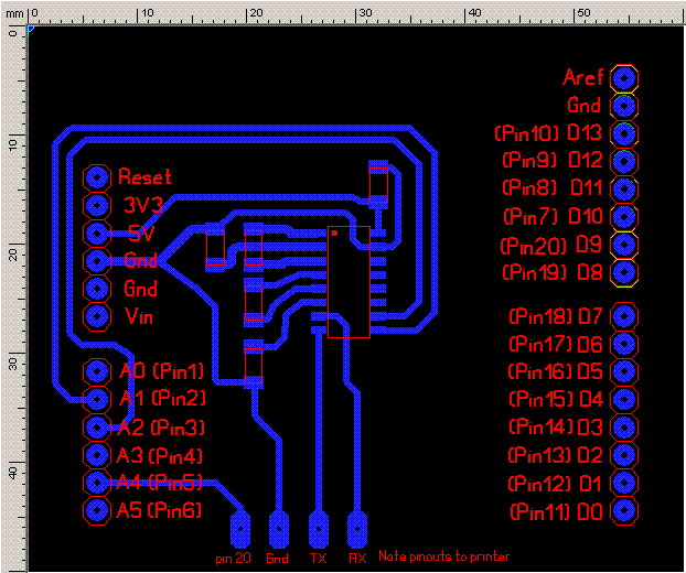

There is a breakout shield board that connects to the 26 pin connector too if you didn't know. I've just designed up a RS232E shield board to use for my printer project as I don't want to risk the onboard RS232 chip.
I'll be tranferring the pcb image via my usual method of the iron on as I have found it gives far better results than 2 copies stuck together and doing the UV method.
Anyway if any other guys are using Sprint Layout for pcb design that Adruino pinout is saved as a macro and I'll be happy to share it if anyone wants it.
Regards Bryan
Edited by Bryan1 2011-12-16

The DuinoMite Eagle files are available for download, to make your own shield all you have to do it to delete the components which you will not use, the Arduino connector is there so you can use it for your shield and add the custom circuit you want around it.

Well, that is not needed because a footprint Arduino shield already exist in Eagle format. Take a board larger than DM and try to stick it in Arduino sockets. If there are some obstacles, then you have some restrictions so, a new Eagle footprint is required. If not, doesn't matter.
