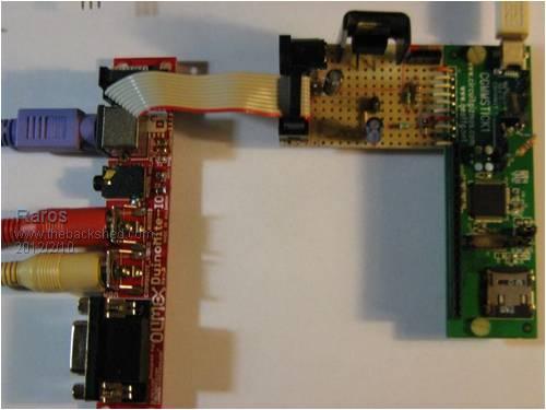

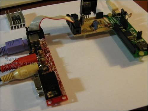

CGMMSTICK1 + Olimex-DuinoMite-IO-Board = Maximite 100%
Hello all.
I am very pleased to have purchased a CGMMSTICK1.

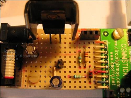

I added the smd resistors on Olimex-DuinoMite-IO-Board
and connected with a simple interface on the stripboard
and is a perfect Maximite at a great price.
Thanks to Geoff and to CircuitGizmos.
The downside, in my opinion, is the MicroSD reader
in very uncomfortable position.
I would have preferred a SDcard reader. Much more practical .....
Thanks to you all.
Raros.
(I used Google Translator.)
