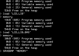

I ran out of program memory.
The screen capture above shows that the incomplete library takes 18kB or 60% of program memory.
The library and its supporting test code takes 30kB or 99% of program memory.
I've attached the code. It tests OK for 4x20 LCD screens so far, but doesn't have some of the functions implemented yet.

Posted: 12:57am 27 Feb 2012
Remove all the debug/test code from the actual Function library
Create a Separate program/library to test functionality.
[code]_LCD_Display$ = ""
_LCD_Cursor$ = ""
_LCD_Blink$ = ""
_LCD_Type$ = ""
_LCD_MoveDir$ = ""
_LCD_Shift$ = ""
_LCD_Type$ = ""
_LCD_Direction$ = ""
_LCD_Bits = 0
_LCD_Lines = 0
_LCD_Font$ = ""[/code]
Most of the above variables could be Integers/data constants
anything except STRINGS
Using configuration file entries for the parameters
(i have a alpha version using config file and drive 2 16x2 plus a 8x2 module at the SAME time) which uses <20% of the memory

That's a fair point about the debug code. I use lots of comments to explain what I'm doing - but people looking at the code are likely to need them. I may need to maintain two copies - one with comments and test code, and one stripped down for efficiency. Hey - that sounds like the basis of an interesting program.
If I split the program into a separate test program (12kB of program memory so far) and a library (18kB), then load the test program and merge in the library, wouldn't I still be using 30kB or 99% of program memory?
I could split the test code into multiple smaller programs and use RUN to manage them, but then I get back to the parameter problem above.
James

I followed djuqa's suggestion and converted string parameters to numeric, and I wrote a short program to strip out blank lines and remarks. Now I have a fully commented source program for developing the library, and a stripped down version for distribution.
Memory usage for the library dropped from 18kb (60%) to 6kb (20%). The lesson is that libraries (not individual subs) may have to do without comments so there is space for users to fit in their own programs, but there will have to be good supporting documentation.
