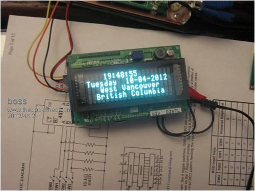

Good morning,
to save precious Maximite pins in my aplication I connected LCD (or VFD) display via SPI (3 wire connection)
2012-04-12_022125_LCD.zip

That is so neat... only 3 pins to control a lot of output.

Thank you Geoff,
and you can concatenate these chips to get as much pins as needed for price 30c/chip include shipping on eBay.

There are two very good tutorials on how to use serial in, parallel out shift registers (74HC595's) for these applications. One at the Arduino site which also has several good examples.
http://www.arduino.cc/en/Tutorial/ShiftOut
The other one is at BILDR blog:
http://bildr.org/2011/02/74hc595/
