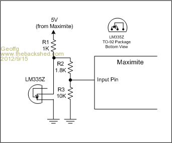

Noticed a strange thing today when I got the temperature sensor in the boiler water and cranked it up for the first time. It would not give a reading higher than 52.6816 degrees C.
I have four temperature sensors: boiler water temperature, house air temperature, house water temperature (circulating in the house for bathing and kitchen), and outdoor temperature. I used LM335's for each and calabrated the voltage based on the particular MM which is 3.26v. The other three work fine as does the fourth until the boiler water temp gets up to 52 degrees. Above 52 degrees it won't give any higher readings. The boiler operating water temperatures will usually be between 80 and 95 C, so stopping and maxing out at at 52 won't do. I put on a different spare temperature sensor and got the same results. The sensor is inserted into a length of copper pipe which is crimped at the bottom, soldered, and inserted down into the water under the closed boiler lid.

The LM335 has an output of 1mV per degree with zero volts at zero degrees Kelvin (ie, absolute zero). So, at 53 degrees C (which is 326 degrees Kelvin) the output of the LM335 is 3.26V which is the maximum that the PIC32 can measure with a power supply of 3.26V. This is why it stopped at about 53 degrees.
When at a temperature of 100 degrees C the LM335 will have an output of 3.73V so you need to drop the voltage using a voltage divider so that it fits within the input range of the PIC32. I recommend using the following circuit:
Strictly speaking you should use precision (0.1%) resistors for R2 and R3 but a simpler method is to measure their value using a digital voltmeter and then substitute the measured values into the following formulae (which MMBasic will work out for you):
Tmp = (((PIN(nn) * x.xx/3.3) / ((R2 + R3)/R3)) - 2.73) * 100
Where nn is the I/O pin that the sensor is connected to
x.xx is the measured Vdd (3.26 in your case)
R2 and R3 are the measured values of the resistors
Tmp is the measured temperature in degrees C
Sorry for the complicated answer but I hope that it helps.

I built the voltage divider and it seems to be working. I have four temp circuits for LM335's on my component board. Three do not require a voltage divider and when the program is running without any sensors these three read between 3.79 and 3.82 volts. I'm assuming the small difference is in the 1.8K resistors.
So on the fourth circuit now modified with a voltage divider as designed above by Geoff I now get a reading on that pin (4) of 3.27 volts. This is lower than 3.8 volts for sure and I'm guessing it will work.
But was is puzzeling is when I attach a known working sensor LM335 to this circuit on Pin(4) I get negative numbers and when I heat the sensor the negative numbers get larger, go down, not up. I'm wondering if I entered the calculation formula incorrectly, or if there is maybe a bracket error in it somewhere?
This MM on the bench reads 3.29678 volts at the four pins without any load so I am using 3.29 as the base voltage. The 1.8K resistor digitally reads 2.02 K ohms, the 10K resistor reads 9.85 K ohms. So here is my formula:
BOILERTEMPCENT = (((Pin(4)*3.29/3.3)/((2020+9850)/9850))-2.73)*100
Am I missing something obvious to others?

BOILERTEMPCENT = (((Pin(4)*3.29/3.3)*((2020+9850)/9850))-2.73)*100
That's a multiply instead of divide.
I would use :
BOILERTEMPCENT = Pin(4)*120.8 -273
and calibrate each sensor by changing the multiplier (120.8) for each

If you read 3.27 volts on pin 4 then calculating by hand that would read about 120 degrees Celcius. That is very hot for water. Do you have a pressure vessel?
To simplify your formula FOR YOUR SET OF RESISTORS only.
(2020+9850)/9850 = 0.8298
so you can use that value in the formula
and 3.29 / 3.30 = 0.9969
so close to 1 you can use that value (for the moment)
Thus you get
((Pin4 volts / resistor ratio) - 2.73)*100
((3.27/0.83)-2.73)*100=120.97 degrees C

To check the maths
At 60 degrees C the voltage at the LM335 should be 3.33V
The voltage at the Maximite pin after the voltage divider should be 3.33 * 9850/(2020+9850) = 2.76 V
=2.76*120.8 -273
=60.408

That works! Yahoo.
Thank you all!
The voltages I reported for the four temperature sensors pins: 3.8 volts on the three regular sensors and 3.27 volts on the voltage divided pin, were all without any LM335s attached. Not actual temperature reading voltages.
At room temperature the voltage divided LM335 pin reads 2.54 volts.
I convert everything to F for my displays. And I just tested my 'high-temp' circuit on my tea and it went up to 159 degrees F. NICE It would not do that before. It's all a go!
I will calibrate each circuit and use the simplified formulas.
