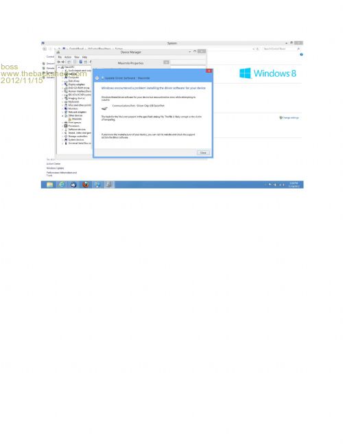

Hi,
after I upgraded Windows7 to Windows8 the driver stop working - see picture. Anyone has solution?
Thanks for answer

I had four Win 7 machines. It would only work on two of them. On the other two it would just hang most of the time and give an occasional odd error message. I'll try it on Win 8 later. I have a Win 8 pro x64 and an x86 machine. I can't read what your problem is, the image is not good after it has been thru Gizmo's upload mangler.

Mine works with Windows 8 64Bit
You will need to put Windows 64Bit into test mode to load the driver
take look here Test Mode

Hi,
I attached the copy of the screen as ZIP file

  jman said   Mine works with Windows 8 64Bit
That links doesn't work for some reason John, so I asked Dr Google and came up with this:
http://laslow.net/2012/03/14/disable-driver-signature-enforc ement-in-windows-8/

Hi,
thank you very much folks. I'll try it tomorrow. I this shouldn't happen to such company like Microchip - it is really embarrassing.

Hi,
it works as described. Thanks!
