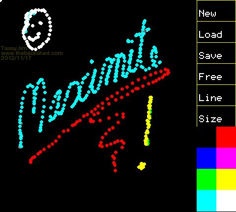

A quick and nasty sketch program to make use of my new touch screen.
My drawing skills are somewhat limited.
(converted from BMP to GIF to upload)
Still needs a lot of work but I am beginning to understand the needs of a touch screen controller.

I am looking at installing a touch screen for 7" LCD screen with a Duinomite Mega. I saw your program on your thread - Small VGA Monitor and will use your implementation.
Can you share the mmbasic program you used to make the sketch drawing above. I am assuming you wrote the program in mmbasic.

This is the program.
You will need to uncomment the call to the calibration subroutine and then change the values for Xslope, Xi, Yslope and Yi.
I found that I needed a resistor in series with the Y axis to keep the current draw down. The X axis at 700 ohms was OK as is.
