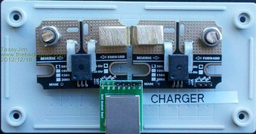

I am slowly gathering the parts for my van monitoring system.
The Allegro current sensors are my choice.
For protection on the other inputs I will use LM324's which are cheap and have reasonable input protection. They can also do a bit of filtering.
The Maximite will have a 7 inch LCD with touch screen to save the need for a keyboard.
I an using LM335's for temperature sensors in the fridge and room temperature.
There is an earlier post here that describes the touch screen.
http://www.thebackshed.com/forum/forum_posts.asp?TID=5291&PN =4
I found it easier to buy these +/- 50 amp modules rather than make my own.
The only load that doesn't go through the CT is the Slide-out motor which draws 100 amps.
I will have 5 amp sensors on the electric brakes to detect when one axle goes open circuit. This has happened once already and it was not very nice!
I should start assembling the main Maximite control unit soon.
