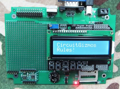

I attached an LCD shield to a ColorMax and wrote a simple library for it.
Here is the LCD Shield library:
' LCDShield library
' Backlight on/off
' 0 = off, 1 = on
SUB LCDShield_Backlight ( LCDShield_blstate )
' pin = 31
SETPIN 31, 8
PIN(31) = LCDShield_blstate
END SUB
' Write 4-bit command
SUB LCDShield_Command4( LCDShield_value )
' Data lines
SETPIN 25, 8 : SETPIN 26, 8 : SETPIN 27, 8 : SETPIN 28, 8
' Register Select line
SETPIN 29, 8
' Enable line
SETPIN 30, 8
' Command
PIN(29) = 0
' Enable high
PIN(30) = 1 : PAUSE 1
' Value onto data lines
PIN(28) = LCDShield_value AND &B00001000
PIN(27) = LCDShield_value AND &B00000100
PIN(26) = LCDShield_value AND &B00000010
PIN(25) = LCDShield_value AND &B00000001
' Enable low then high
PIN(30) = 0 : PAUSE 1
END SUB
' Write 8-bit character
SUB LCDShield_Character( LCDShield_value )
' Character
PIN(29) = 1
' Enable high
' Value (high nibble) onto data lines
PIN(28) = LCDShield_value AND &B10000000
PIN(27) = LCDShield_value AND &B01000000
PIN(26) = LCDShield_value AND &B00100000
PIN(25) = LCDShield_value AND &B00010000
' Value (low nibble) onto data lines
END SUB
' Write string
SUB LCDShield_String( LCDShield_string$ )
FOR LCDShield_loop = 1 to LEN(LCDShield_string$)
LCDShield_Character( ASC(MID$(LCDShield_string$, LCDShield_loop )))
NEXT
END SUB
' Return button state
' 0 = no button
' 1 = right, 2 = up, 3 = down, 4 = left
' Because A/D on CGCOLORMAX is 3.3V max and this is a
' 5V resistor chain the SEL button does not work.
FUNCTION LCDShield_Button( )
' Button Input line
SETPIN 35, 1
LCDShield_Button = 0
IF PIN(35) < 2.85 THEN
LCDShield_Button = 4
ENDIF
IF PIN(35) < 1.95 THEN
LCDShield_Button = 3
ENDIF
IF PIN(35) < 1.1 THEN
LCDShield_Button = 2
ENDIF
IF PIN(35) < .32 THEN
LCDShield_Button = 1
ENDIF
END FUNCTION
Here is test/example code:
' LCDShield example
' Flash display
for a = 1 to 5
LCDShield_Backlight( 0 ) : PAUSE 40
LCDShield_Backlight( 1 ) : PAUSE 60
next a
' Initialize display
' Select 4 bit mode
LCDShield_Command4(&H03)
LCDShield_Command4(&H02)
' Select 4 bit mode, two LCD lines
LCDShield_Command4(&H0C)
' Select display on, cursor off, no blink
LCDShield_Command4(&H00)
' Clear display
LCDShield_Command4(&H01)
' Write Hi Mom! message to line 1
LCDShield_Character(72)
LCDShield_Character(73)
LCDShield_Character(32)
LCDShield_Character(77)
LCDShield_Character(111)
LCDShield_Character(109)
LCDShield_Character(33)
PAUSE 1000
' Clear display
' Write message to line 1
LCDShield_String ( "CircuitGizmos" )
' Move to line 2
' Write message to line 2
LCDShield_String ( "Rules!" )
' Test buttons
for a = 1 to 500
PRINT LCDShield_Button()
PAUSE 1000
next a
