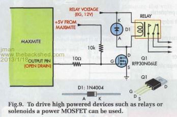

Hi again (sorry for been a noob)I built my little project and it does what its ment to (with a LED) turns off when pin1 =1,but when I connect a relay thinking power one side of relay pin1 other nothing happens?do I need a transistor to drive it?

You sure do need a transistor or mosfet
That is from the original Maximite article

Thanks can I use a transistor,as its only a 12V relay?(I also have a lot of transistors)
Heppy
Posts: 4384
Posted: 03:11am 19 Jan 2013
You need the diode etc as well.

Thank you ,that work great

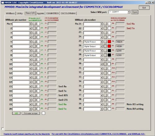

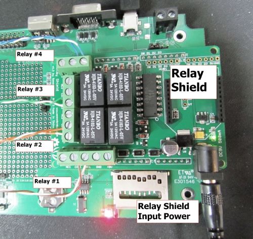

Here for reference is a relay shield on a CGCOLORMAX1.
And controlling the relay with MMIDE 3.

Something to bear in mind, is that not all 12v relays are equal in terms of what their coil current is.
While it is certainly true that you can drive small DIL PCB relays with a single transistor such as a BC548 as their coil current is so small, for larger relays(like a 12v car "Horn relay") that have a much higher coil current, you have to use a Darlington transistor with much higher gain and current rating - or use two discrete transistors in a Darlington arrangement. ALWAYS test this on the breadboard BEFORE you make your PCB's like I DIDN'T at one stage, then found that the single transistor could not switch the large relay...
I always prefer to configure my relay switching so that the transistor sinks the coil current rather then sourcing it, but as the page that jman linked to states, you can do it the other way, you just need extra parts.
