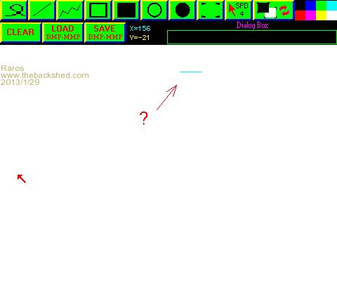

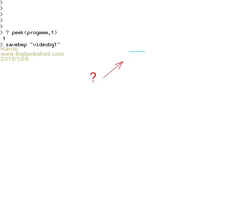

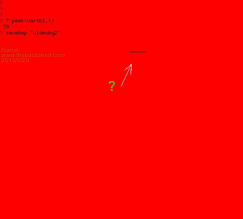

On my maximite (UBW32 + Color MaxiMite adapter by MGB), with firmware v4.1 or v4.2 a strange thing happens:
When you run a Peek: PEEK (keyword, ± offset), with any 'KEYWORD' the video gets dirty with a line.
The background not must be black.
My card is defective or is it a bug?
Maximite is connected to my keyboard, video-vga and sdcard.
While here the mouse is connected via RS-232.
(Save portion of the screen with peek RVIDEO, GVIDEO and BVIDEO)
Can anyone try it?.
Thank, Raros

Doesn't happen on my B&W MM.
Hugh
p.s. Just tried again in reverse video and I do get something similar. If I run this twice
font#1,,1:For i=1 to 500: ? peek(progmem,i);:next
I get a black line through characters 6 thru 11 on lines 3 thru 9 on a colour VGA monitor.Edited by shoebuckle 2013-01-30

Ah, a bug... and just when I thought that I had squashed them all.
Thanks for the heads up, it will be fixed in the next version.
