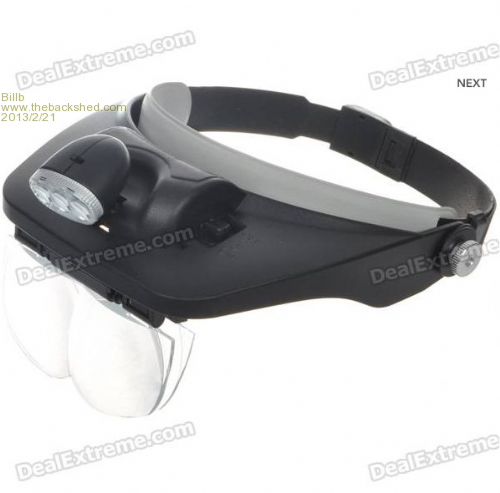

Bill.b
Joined: 25/06/2011
Posts: 249
Posted: 09:45pm 20 Feb 2013
Hi Mick
I find this a great help when checking my boards and soldering.
http://dx.com/p/light-head-magnifying-glasses-with-4-pie ces-different-multiple-lens-3-aaa-51583">
Bill

@Bill,
Yes, they are great. Downwind and I both use something similar - I don't find the head lamp much use though and prefer a back light and desk lamp.
As far as flux goes, I used FRY's flux paste (like a grease) for decades until it got too crappy from dipping my iron tip in back in the copper tip days (remember the scope and mini scope and the solder gun?).
All I use these days is zinc chloride and a cotton bud. Zinc chloride AKA Bakers soldering fluid. It might sound a bit fierce but it can be watered down. I have never had a problem with it. Most boards can be washed down with water and dried with a hair drier. I put sockets on after the job is washed and dried and the flux finished with.
I used it to solder the PIC32 (TQFP 100) the other day and it went perfectly. That is just using a fine chisel point iron (temp controlled).Edited by MOBI 2013-02-22
