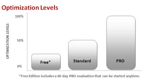

As anyone knows, Microchip will replace his own C compiler for PIC18 with the one acquired from Hi-Tech, named XC8, providing support for all microcontrollers (from PIC10 to PIC18).
But, there is and incredible issue. XC8 is at version 1.12 by now and it still come with the Hitech licensing scheme. I mean, there are free, standard and pro versions, with difference in the offered optimization:
Why I say incredible? Until now, MPLAB C18 was (it still is) a very nice option regarding to C language for PIC18. In free version, it outperformed (the also free version of) XC8 in all aspects. And I didn't believed to my eyes when I saw the linux version!
So, for linux guys, until Microchip decide what will do with XC8 (hopefully, in free version XC8 will be as good as C18), there is still C18 for linux, available for download.
