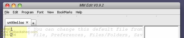

Hi.
I just installed MMEdit & MMEdit2 on OS X with Crossover 13.1.2 (commercial version of Wine 1.6)
Results:
MMEdit 3.4.6 - Installs okay, locks up completely when i open the "Maximite Chat" window immediately after the MMBasic logo from the device is displayed.

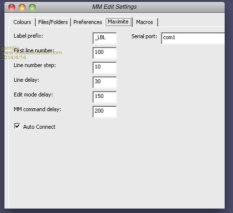

MMEdit2 0.9.2 - works okay, is able to "talk" with the device, has some cosmetic issues:
1) Icons missing in editor
2) Default size of "Settings" window too small, Save button is off-screen.
I'm available for more tests if needed.

With MMedit2, can you resize the settings window?
I have made it remember the size of the window in later betas but not sure where I was up to on the one I released.
I expect (hope) that it's hiding the toolbar with the tabs and not failing to write it in the first place. That might be something I can fix.

psergiu
Joined: 09/02/2013
Posts: 83
Posted: 12:56pm 14 Apr 2014
I installed TerraTerm, it can "talk" to the Duinomite-Mega but there's a strange ~1sec delay from my typing until i get a feedback on the screen.
Tried at 9600 and 57600, same delay
I'm using the Windows version. There's no Linux emulation for OS X as far as i know.
I can resize the settings window in MMEdit2 by the lower-right corner - there's no GUI decoration for that corner and the mouse cursor does not change - i guess that's Wine's fault.
The toolbar is there, when i mouse over the button locations i see a little "raise" animation for a 3-4 pixel high area. I clicked one in the left side and i got the "Save" window.
MMEdit2 zip file is unpacked in c:\Program Files\MMedit2, the Data dir is in there.

It looks like CrossOver doesn't return the size of my toolbar. It is good that it is there even if it's too small to use.
I can add a check to add a default size if the true size is not returned.
I still have to do a lot with MMedit2 in the terminal screen area but I will try to get this little fix done over Easter and put a new beta out next week.
