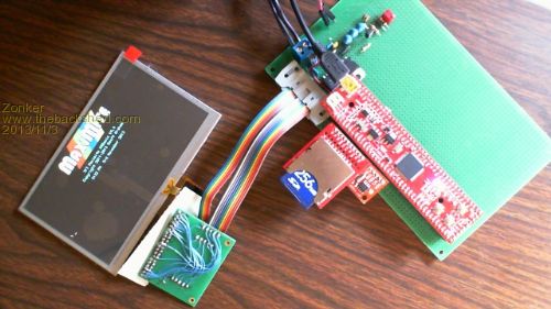

Is there a current version of the TFT-Maximite code that is loadable to the UBW32 using the USB port ?.. I am using the v4.4 version from Jman but the demos don't seem to run without causing syantax errors...
Example: Y = touched(#Y) will cause an error..
In the SKETCH program, there is a line that uses touched(#S)... I can't seem to find that (#S) in the manual..
Also, some of the objects, like LED's don't seem to draw
Not sure what to do with this... I am still running the UBW32 with the original boot loader in it. Maybe that's the problem... Not sure...
Any advice from anybody would be quite helpful. Thanks.!!

Several months back, Bovist got a special version of MM Basic modified so that you could connect it to LCD Display modules instead of a VGA screen, and added in touch control as well. (awesome!) Jman was one of the first to get a 5" Innolux A050-33 LCD touch display unit working with a UBW32 as the MM engine. Since I had a UBW32, I thought, this is the project for me... I had an idea to prototype up an EIS system, and this combination UI would save me more than half the cost of using a touch display from 4-D systems. Thanks to lots of help from Jman, I managed to get one booted up and working. The Things I was asking about are from the "TFT" version of the firmware, and are in the PDF manual of new LCD commands...
I think this subsystem is an awesome addition to the MM project as a whole and quite useful for many projects out there... Next, I think I will try to find my PICkit-3 and download the version of firmware that includes the replacement bootloader and try the demo code examples again... More info:

Just an update. Dave wanted to know how to gather the things to build one.. Well, I found the same 5" display that Jman was testing out from of all places, Amazon.com. They sell them as replacement screens for phones I think.. Got 2 for about $50.. not to bad.. I wanted to tame down the 40 pins coming out of the display to just the 16 wires needed to drive the interface before heading off to the UBW32, so I got a 40 pin display interface board from Newheaven display. They offer several types of boards that should work ok. I got the NHD FFC40 board. If you follow the posts from Bovist, he points to a place on GitHub that has download firmware and doc's... Also, Geoff has a website (mentioned above) that has information also.
I started with the "Bovist_mm_hex.hex" file loading over the USB port. After adding an extra wire I had somehow left out, I got the basic unit booting. After going over a few of the demo programs, I noticed that many of them were producing syntax errors when trying to run them. After playing around with the example code awhile, I found out how to redo the statements to avoid the syntax errors. Now, to follow this, you will have to read the PDT doc's on the LCD commands, but lets pick one of the commands used to create an active object on the screen.
Touch Size 25,100
Touch Create 6,370,50,"",purple,V,B,N,D
After setting the size, you would create a vertical purple slider object 6 like seen in the SLIDER.BAS demo program. It looks good and seems to fit the descriptions in the PDF doc file, but was causing the syntax error when run. By leaving off the commas on the "options" section, I got the object to draw ok.
Touch Create 6,370,50,"",purple,V,BND
Another example in the SKETCH demo checks if the last user touch is within a certain area of the screen, and if so, draws a small circle where the user touched the screen. I think the (#S) thing was a typo and should be (#Y).
if Touched(#Y) and Touched(#X) < 360 then
Circle(Touched(#X),Touched(#Y)),2,my_colour,F
endif
The Touched functions should be returning the X and Y position of the touch and if in range, draws the circle at the users touch point... nope, syntax error... oh boy.. here we go again..
Anyway, the answer to this might be having a version of firmware that is not as "fresh" as it should be. Not sure... I was wanting to try out the version of firmware offered at the Geoff site, but the image includes the boot loader so you have to program it with a PICkit-3 device. I have one and will try to get it setup and working to try out that firmware. Jman also sent me a v4.4 image that seems to load ok over the USB with the original UBW32 boot loader. This is what I have been playing around with the last few days...

One of the issues with the code for the TFT Maximite was that it was evolving as new touch screen features were tested and sometimes discarded. The code is stable now and I have updated the documentation to match. You can download both from http://geoffg.net/tft-maximite.html (scroll down to the bottom of the page). Be aware that some of the early demos are now incompatible with the latest release (V4.4B).
Also, the source for all versions (including the TFT Maximite) is available from http://mmbasic.com.
I should mention that there is a new version of MMBasic (V4.4B). This fixed two minor bugs but the main reason for its release was that it included support for the TFT Maximite. I have one of them and it is a delight to use. The display is bright and generates vivid colours with sharp images. The whole package (Maximite + LCD display) is just a little larger than the LCD display itself and it makes a neat package which can be easily mounted in a panel.
My web page (http://geoffg.net/tft-maximite.html) has more information plus a pointer to the schematic and other data that was developed by Carsten Meyer (Bovist) for c't magazine.
Zonker, to save you having to dig out your PICKit3, attached is a version of 4.4B for the TFT Maximite without the bootloader. 2013-11-04_133928_TFT_Maximite_MMBasic_V4.4B.zip. Don't forget to download the latest documentation to match.

Update: The new firmware seems to be running all the demo programs just fine..!!
Big thanks goes out to Geoff, Bovist and Jman for help and foresight that makes this device do most of the work..!! Should make an excellent platform....
