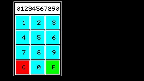

Currently spending a little free time happily creating some screen objects for the TFT-MM... One of the first UI objects I want to try is a simple numeric keypad to enter ask for values needed for a setup program. So, after playing with some Touch Sizes, seems like 50,50 makes a button about finger size on the screen. After creating the basic "phone pad" layout, it seemed to look ok. While I was tinkering, I started to think about what would be the "proper" way to create different kinks of "ready to go" UI objects and get a library going that everyone could use. Now on a scale of 1-10, I am about a 2 (knows just enough to be dangerous) code writer...
Having said that, I would entertain starting a discussion about the "do's and do-not's" of good UI object creation. Now, being a "nubbie" at most of it, I figure a few good questions about understanding how things work on the TFT-MM should get the pot boiling...
1} Should UI objects be written as functions.?
Example: my_num = key_num(max_keys,min_val,max_val)
2) within a function, can you create and dispose of objects without disturbing other active objects in the main program.?
3) What is the proper method of overlaying a UI object, like the numeric keypad for example, on an already existing screen and returning control back to the main program, screen and any active objects of the main program in tact.?
4) is it a good idea to use the touch interrupt to change the color of the touched key, then wait for release.?
I can think of many more questions... But, before I babble along to much, I would like some feedback on how "we as a group of coders" could develop a working set of rules and structures to properly create a good reusable UI library that everyone could use...
Any feedback would be welcome reading... (level 2 "nub" class here)
Thanks..!!

Hi Zonk,
You are probably not going to get many answers as you are one of the first people on the planet with a TFT Maximite. So, I thought that I would chime in.
1. It would be great to encapsulate everything in a single function - if you could. It would be so simple to use that there would be little to go wrong when people used it.
2. If the controls were created in an empty part of the screen you should be OK to create and remove them at will inside a function. I am not exactly sure what would happen if they overlapped something already there - probably chaos.
For people who are not familiar with the TFT-MM (99,9% of the people on this forum) a control is something created by MMBasic on the screen like a button or LED or switch that can respond to touch. They can be created and removed by the running program.
3. I don't think that you should overlay controls. The controls were not designed with that in mind.
4. Using the interrupt facility would be an excellent way to go. Most controls animate when you press them and return a value when released but that is not a hard and fast rule.
Again , for anyone not familiar with the TFT-MM, you can attach an interrupt to a control so that when it is touched the interrupt function will be called.
When you get your new UI objects running you should package them up so that they could be loaded with the LIBRARY command. That would make it easy to incorporate them into other programs.

Just got back from choir practice.. The earlier post (I think) was talking about the signals on the 40 pin display connector. The Hsync (pin 32) and Vsync (pin 33) signals are not needed for the 5" display.. But you should connect them up anyway to be compatible with the 4.3" unit. that way, you can plug-in either unit. I know the way that the 4.3" unit interfaces the touch pad is different and does not use the last four pins as the 5"... The InnoLux PDF file suggest to us a HIROSE FH19SC-40S-0.5SH connector, but there are many different ones that should work. I have created an Eagle part for this connector.. (it's small!) I used the Newhaven board to compact the 40 wires into a 16 pin IDC connector for the prototype build. It just made it easer to get the wiring done.. I too was thinking about creating a PCB of this "MM-Panel" I am trying to figure out if there is any left over I/O pins from the other group of pins that can be brought out to get the MAX I/O I can. I am still creating the parts, but want to complete a schematic in Eagle of the project, but I am still in the "creating library parts" stage... However, I did manage to tinker around with my first UI object, the "get_num" function will collect a number from the user, check for proper value ranging, and return the entered number data back to the caller.
Example: mynumber = get_num(L,0,350)
get user number, Left side, minval=0 maxval=350
One thing I found out... Fingers are big...

  Zonker said  Now, another question.. Let's say the user in the main program creates 3 objects, declaring object numbers or 0,1,and 2. If the UI function also declares the same object numbers and then removes them before exiting, will that affect the object list in the main program.? I guess what I am trying to say... Is the object list stack based.? If so, then creating, using, and removing UI LIBRARY objects should be transparent to the function user... (sweet) If not, then maybe it's possible to reserve a group of object numbers as "never use" while using UI functions.
The reference numbers are global - so you will have to reserve a block of numbers for your functions.

There are two ways to preserve what is under a control.
You could copy the area which you are going to use and when the control is done you can write that image back. SAVEBMP/LOADBMP can do that, but i do not know if it is fast enough. Even simpler is to just copy the whole screen.
Another way is to have a 'paint' option in every control.
If called then it will repaint itself. Windows uses that strategy a lot.
You would need to know the order in which they were drawn on the screen but that is relatively simple to maintain in an array.
When you remove a control you simply call the 'paint' function of every control previously drawn that occupies a part of that screen.
Some bookkeeping required, but it should not be too difficult.

The system used here is a lot simpler than Windows (as you would expect). There is no "paint" function (or overlapping windows). You can create a control, respond to touch on it and remove it.
Geoff
MicroBlocks
Joined: 12/05/2012
Location: Thailand
Posts: 2209
Posted: 12:17am 08 Nov 2013
I was responding to point 3 in the OP.
The "paint" function would be part of the control you make.
Maybe "redraw" would be a better name.
Effectively it just draws itself again just like the first time you use it.
The only thing extra is that it should show the same values if something was entered.
If you are going to make a bunch of controls it can be a choice to implement it that way.

I wanted to start with a keypad that would collect a number from the user. I haven't wrapped it into a function yet, as I need to add max value checking. if you run it, you will get the keypad object on screen. C clears and E ends the input. Just testing the action code for now...
2013-11-09_072644_KEY_NUM1.zip
Any feedback welcome..!
PS: After looking over the many fine demo programs for the TFT-MM it looks like most of the pieces could be turned into UI objects.. Wow, I am impressed with good code writing within... One question about functions...
If you write a function to, lets say display the "Graf" object as seen in the demo program "aninstr.bas", can you include a timer interrupt service routine within the function code. When the function is called, the object would display itself at the user supplied x-y and update duration time. the timer would then simply read the user supplied data variable and update the "Graf" object. (nice)
Anyway, more stuff to think about...
Humm.. 31 is the highest object reference number allowed...Edited by Zonker 2013-11-10

  Zonker said  If you write a function to, lets say display the "Graf" object as seen in the demo program "aninstr.bas", can you include a timer interrupt service routine within the function code. When the function is called, the object would display itself at the user supplied x-y and update duration time. the timer would then simply read the user supplied data variable and update the "Graf" object. (nice)
That should work but for the definitive answer try it yourself.

I managed to scratch together the first test release of a single object library for the TFT Maximite. It ain't much, but I wanted to try out the "process" and get some feedback before going much further...
2013-11-13_002743_Z-UI1.zip
any advice on better programming of this stuff would probably help..
