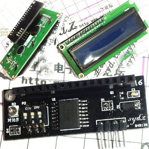

Hi
I thought I would share my little program I use with a cheap EBAY I2C
LCD interface.
These are very cheap seem to work quite well.
I2C LCD
The attached file will drive a character LCD with the following commands
ClearScreen -- Clears Screen
LCDLine X, "Text" -- Writes the "Text" to Line X Max 4 Line LCD
Light = %B1000 -- Turns the Backlight on use before LCDLine
Light = %B0000 --Turns the backlight off use before LCDLine
Don't forget the pullup resistors on the I2C
The dip switches all need to be in the on position for address &H20
2014-01-05_094340_I2CLCDS.zip
Jman

jman
Joined: 12/06/2011
Posts: 711
Posted: 11:18am 05 Jan 2014
Nice find Paul
Those adapters have a different layout to the one I have linked
the software will need a few minor changes to make it work
Jman
