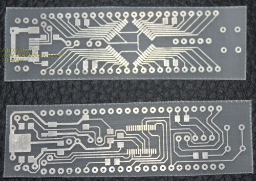

I use 0.8mm board and a HBC220 modified laminator - no problems so far!
  Quote  How do you ensure layer registration doing double-sided boards like this at home? If you are not EXACTLY right, tracks and pads etc top and bottom won't line up. This is basically why I don't ever try DS boards at home - I always get the PCB house to make the prototype.
A smart little trick to create a very accurate double sided PCB is to use two 0.8mm single sided copper clad boards etched separately.
I place a wire pad on each corner (outside the required area) as a guide for alignment. Once both boards etched, drill through the four wire-pads as accurately as possible on the first board, then repeat for the second board. Then simply line the two PCBs back to back using a component lead off-cut to line up the boards.
End result is a 1.6mm PCB with near perfect alignment.
Hope this helps . . .

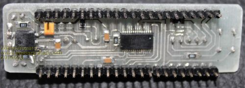

Update:
Below are the two boards making up the double sided PCB.
Ignore the rough cut - I will file this down, and round the corners, once boards attached to each other.
Only one short detected on FTDI chip (bottom board).
Will update picture once boards attached

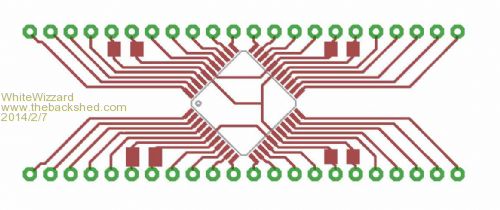

Hi,
Thanks for everyones feedback. In response to Rob and Lou, my original idea was for a very simple single sided PCB comprising with just the TQFP and caps - creating basically a 44 Pin DIP to plug into a breadboard (see below).
This basically becomes as easy to use as the 28 Pin PICs but with all the extra pins of the TQFP package.
If anyone is interested, I will gladly provide the Gerber files for this PCB for people to make at home.

What size SMD caps are you using?
1206's?
Apart from the 47uF cap on pins 6 and 7, the others are 100n PSU filter caps I guess?
Posts: 2991
Posted: 09:48pm 07 Feb 2014
  Grogster said   I'd be very interested in the Gerber for this.
I will see if I can put up a web link later today.
  Quote   What size SMD caps are you using?
1206's?
Correct
  Quote   Apart from the 47uF cap on pins 6 and 7, the others are 100n PSU filter caps I guess?
Correct again
All that is required is a usb-to-uart module and a ICSP (+10K on MCLR).
However beware of any max current limitations from the usb-uart module as some are very low. Its fine if you're not driving many outputs but as soon as a few LEDs are used,for example, then I strongly would recommend a dedicated 3v3 LDO to prevent unusual behaviour.
My preference is MCP170x (available in breadboard friendly packaging). Another trick I use when more than 200mA is required I tend to use multiple MCP170x's (rather than stressing them to their 250mA limit).

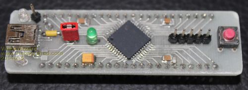

Posts: 2991
Posted: 03:42am 08 Feb 2014
Hi,
Prototype now finished .
Loaded HEX file and everything worked first time (I really like this about all of Geoff's projects!)
Top:
ALL 44 pins brought out to the two rows of header pins. Pin 1 bottom left, then anticlockwise to pin44 on top left (Identical to a DIP)
Tx Led (top left)
Mini USB (COMS and/or 5v power in)
Rx Led (bottom left)
Single Pin next to Tx Led = USB 5v output
Red Jumper = Disconnects 5v USB power from circuit (i.e. on/off switch)
Green LED = 3v3 Power (from onboard dedicated reg)
47uF tant below green Led
ICSP 5-pins
Reset Switch (keeps Tera Term connection open while reseting PIC only)
Note the positions of the reset switch and ICSP mean that you cannot connect a PicKit3 the wrong way round (Come on - we've all done it at some time! )
I've included 3x0.1uF decoupling caps to eliminate any issues (even though the 28 Pin PIC worked ok without them)
Bottom:
3v3 Dedicated 1A LDO (LF33) (left)
FT232RL USB-to -UART (centre)

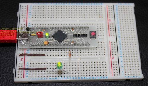

Posted: 03:58am 08 Feb 2014
And here it is in operation. Doing the usual thing first - blinking an LED.
Note this is on Pin 15 - no issues
Also to confirm that there are three available breadboard holes either side of the module (angle of photo clearly shows this on the bottom row)

Posted: 11:17am 08 Feb 2014
  WhiteWizzard said   Hi,
A fine job Phil. I find it very hard to fault as it seems to tick all the boxes.
Just a couple of items.
A single pin for +5V out? It would be good if you can squeeze a GND pin beside it, rather than the user chase the appropriate GND pin on the 44 pin DIP device, or elsewhere on the board.
I assume it could be used for 5V in, or 5V out?
A 5 pin PIC ICSP header?
