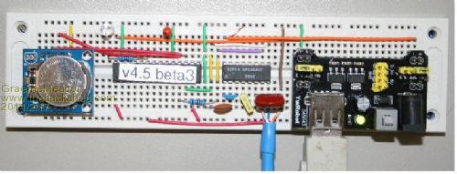

Hope someone can see the error of my ways. I am trying to set and read the RTC on a I2C 1307 module with the Micromite.
The module and original code supplied by Jman in 2011 works perfectly on the CGMMSTICK1 and the Olimex Diunomite Mini both running MMBASIC version 4 but I cannot get the result from the Micromite running Version 4.5 beta.
Hope someone on the forum can shed some light on my problem.

Hi Graeme,
My i2c functions seem to be doing "funny" things since I loaded up the latest beta. I have been using external i2c RTC, hex keypad and LCD. Everything appeared to be working ok on the previous beta version.
I am in Adelaide at the moment and won't be home till tomorrow evening where I can do a few reversion tests. Is it possible that the DS1307 and the "uM inbuilt" RTC command are in conflict - the addresses of both chips may be the same but the registers not? Just wondering as I don't have the data with me.

I am using a PCF8563 and the inbuilt chock commands but I do have a DS1307 (somewhere) that I can test your code with.
I am not having any difficulties with other I2C devices on the MicroMite 4.5b6

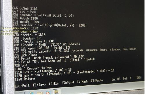

The code I am using is:
' Original Program for getting time and date from external RTC
' Presented by Jman 07/2011 on TBS altered for the Micromite V4.5beta3
600 ' Get time from time$ and date$

Hope I got it all
I have tried pullup resistors from 4K7-20K with no change.

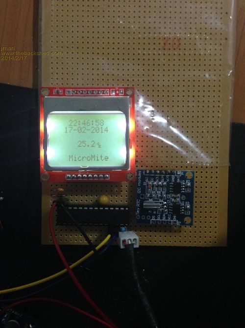

And a little Picture of it going
JmanEdited by jman 2014-02-18

hey Jman...
What kind of display are you using there..? Is it an IIC device also..? How do you talk to it..?
Thanks for any info..!

  Zonker said   hey Jman...
Hi
The display is a Nokia 5110 LCD. They are pretty cheap from Ebay
Nokia 5110
they display has an SPI interface so pretty easy to talk to
these display's are 84x84 pixels with NO built in fonts. The cool thing
is you can make custom graphics real easy (Like my degree symbol)
I can post my code if you are interested ?
Jman
BTW
Hope we are not hijacking this thread If so Glen please could you move it

Jman are you using beta 3?
This code still returns MM.I2C=1
jman
Joined: 12/06/2011
Posts: 711
Posted: 11:09am 17 Feb 2014
Hi Graeme
I am using Beta 6
That error suggests a hardware error
Jman
What voltage are you running the DS1307 on?
It needs 5V.
OA47
Joined: 11/04/2012
Posts: 1051
Posted: 12:08pm 17 Feb 2014
  TassyJim said
It needs 5V.
Jim, you cracked it. The extra 1.7v made all the difference.
Thanks for your assistance and the other Shedders for their help.
