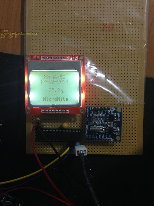

Ok so it seems the Nokia 5110 LCD has drawn a little attention
This are driven by the SPI interface
They are completely graphic displays (No built in fonts)
But his means we can make our own cool fonts and pictures
In my previous I made an error the resolution is 84x48
They are 3.3v so perfect for the UMite. add a 47ohm resistor in
series with the backlight
Attached is the code I used for Clock / Temp display in the Pic.
With the Maximite I normally load the fonts from the SD
The little board in the picture has a DS1307 and 24c32 eeprom I have also
used the eeprom to store the fonts. The attached listing has the fonts
in the main program
2014-02-18_072256_Nokia5110Clock.zip
Take a look at the listing the fonts are near the bottom.
There a few utility's that will convert BMP's to Hex codes
I will dig them out and post them
Jman

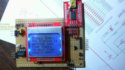

Joined: 18/08/2012
Posts: 772
Posted: 06:37pm 20 Feb 2014
One Picture says it all..!!
Awesome display for the uMite..!

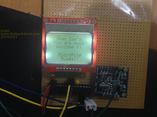

jman
Joined: 12/06/2011
Posts: 711
Posted: 07:28pm 20 Feb 2014
I could not resist

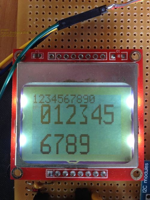

Can you tell me where to find info on making my own fonts.
I want to be able to display numbers in a larger font maybe 3 times normal size.
I have ordered some screens but have not arrived yet.
Paul.
jman
Joined: 12/06/2011
Posts: 711
Posted: 09:41pm 22 Feb 2014
  palcal said   Jman,
Paul.
Sure
I use a little program that I have attached
If you are just want bigger numbers then just make a
set of larger numbers no need to do the whole table
I am busy with an update to the code to allow different size fonts
Once you have the numbers created drop me line and we can get them
added to the current code (That way you get use them fast)
2014-02-23_073543_fastlcd.zip
Don't forget to set the grid size to 84x48
The standard fonts are 7x8 and the left most column is blank
This software will also allow you to create a complete screen
(Like a cool splash screen at startup)
Let me know how you get on
Jman

jman
Joined: 12/06/2011
Posts: 711
Posted: 09:09am 23 Feb 2014
  BobD said   jman, how extensible are your routines? I see an number of graphics LCDs on eBay etc. that are 128 x 64 and even larger. Can your routines handle those sizes?
It will depend on the chipset that the display use's
I am keen to try a larger one so watch this space
@ Paul
Is this what you are after
