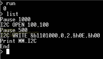

Posts: 10048
Posted: 09:58pm 07 Mar 2014
WORKING!
I have my 1Hz blinking LED on the SQW output pin.
Will post code etc in a moment......
EDIT: OK, here is a screenshot of the code on the uM:
I started reading my way through the datasheet for the 3231, and naturally enough - it was all explained there - funny that....
In the case of the 3231, you send the slave address byte, followed by a register address byte, followed by the data you want to read or write to that register.
Above code sets register $0E to $00, which causes the SQW output to oscillate at 1Hz for my "Ticking" LED.
Edited by Grogster 2014-03-09

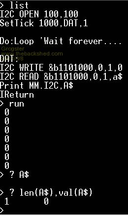

OK, trying to write your suggested routine, for the purposes of experimentation and learning.
This is what I have:
How come A$, which should be the value of whatever seconds is, is always zero?
Should it not be incrementing each time I read it?

Posted: 11:07pm 07 Mar 2014
Grogster,
val(A$) is 0 because there is not a valid numeric in that variable. You have to format the data from the clock. The data in the time registers is two 4 bit numbers which each have to be converted to decimal and added together.

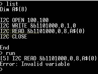

I2C write I2caddr, 0, 1, 0
I2C Read i2caddr, 0, 8, RTCbuff(0)
This will set the address to start reading at 0
then read the contents of 0 thru 7 to RTCbuff(0)
Jman
Posts: 10048
Posted: 11:44pm 07 Mar 2014
OK, tried a little more on this - reading into an array is rejected.
I suspect that this is perhaps because there was mention that the RTC code supplied in the zip was meant for a MM, not a uM, so that might explain why it does not want to behave as expected.
EDIT: I might have a play with the EEPROM chip now - getting frustrated with the RTC.
This is not to say I am ready to give up on it - far from it - just want to try the other chip on the same module. Edited by Grogster 2014-03-09
Posts: 4384
Posted: 11:55pm 07 Mar 2014
  Grogster said   OK, trying to write your suggested routine, for the purposes of experimentation and learning.
Try ASC(A$) or if A$ is an array then ASC(A$(index)) where index is the element number you want.
By way of example, suppose A$ was a space. VAL(A$) would be 0. ASC(A$) would be 32 (because the ASCII value of a space is 32).
JohnEdited by JohnS 2014-03-09
