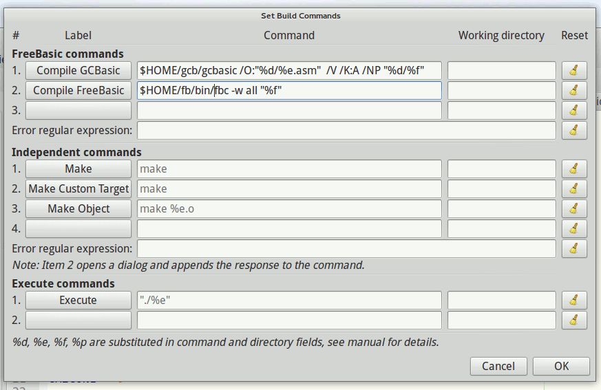

You set the building commands like this

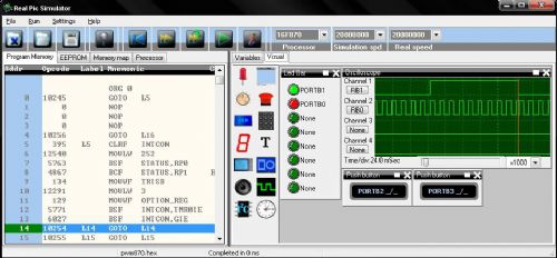

I've found the best IDE for Great Cow Basic is the SYN@GCB by Frank Steinberg.
Its based on the SYNWRITE by Alexy T.
I modified GCB@SYN to include some Arduino style buttons and added PICkit2 programming to my version at my site GreatCowBasic.com .
PICkit 2 gives you one click compile, program and then access to the PICkit 2 UART tool and Logic Analyzer.
You can also install the low cost Real PIC Simulator and the links are already setup.
Real PIC Simulator allows you to debug your project with simulated hardware and step through the assembly code and run to breakpoints.
Or import the assembly file into MPLAB and simulate there.
Real PIC Simulator is $29 but the rest is free.
Real PIC Simulator Screen Shot

You did an excellent job, I tested it before and is great. I guess is only for Windows...
Geany provide only basic functionality but works on Linux and is a cross platform IDE. With Geany I do also JALv2 projects. It can be also used for AVR but I prefer Eclipse for that.
We always had very good tools under Windows - Linux was the problem when it was about PIC development but now we have many good choices.
