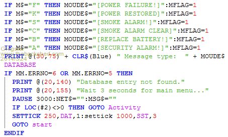

Is it just me, or is the colour syntax and colour missing from any LOC command?
Any time I use it, everything after the LOC command is just lower-case black.
The LOC command itself is capitalized and blue, but anything after that...
Example:
IF LOC(#2)<>0 then FlagNET=1
...or...
Q=LOC(#2)/21
I would have expected the THEN in blue and capitals for the first example, and the 21 in red for the bottom example.Edited by Grogster 2014-03-20

Its not LOC that's the problem, its the hash "#"
The code I use for highlighting (scintilla) wants to treat the "#" as a type of comment marker so it stops formatting for the rest of the line.
This is because I have started with code rules for another language and modified where possible for MM Basic.
Try this:
IF "#" THEN ' OK here because it's in quotes
IF # THEN ' not happy
I have had more luck with MMEdit2 and it doesn't have the same problem even though we are using the same scintilla control.

Just an update - when I loaded up MMEdit2 version 0.9, ALL the colour syntax is correct - the user-defined subs(normally black) are correctly capitalized in purple, and the syntax after the LOC command is also correct.

...I note that one of the SETTICK commands is still black, but the LOC and user defined subs are correct.

The cause of the second SETTICK not highlighting is the ':'
Multi-statement lines were a problem but I think you will be pleased when I get around to releasing the next beta.
