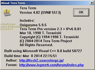

Posts: 2552
Posted: 02:49am 11 Apr 2014
interesting - perhaps there are multiple compiles available out there?
here is a snapshot of the 'about' screen from mine:
nonetheless, it does sound like 'TTY Record' and 'TT Replay' are intended for something quite different from what i had assumed. many thanks to those who helped solve this one. in future i shall use the 'Log...' option instead!
rob :-)
Posts: 2981
Posted: 03:49pm 11 Apr 2014
Hi Rob,
My laptop has the Record TTY options.. I installed the latest 4.82, to see if it was different, and I see that I have other install options on my laptop checked... When I installed TT to my desktop I unchecked everything except the first box TT+Macro.. So it must be something to do with one of the other install options.
