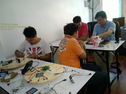

Last weekend we had two workshops for Micromite beginners.
As this was the first workshop it was a learning experience for me too.

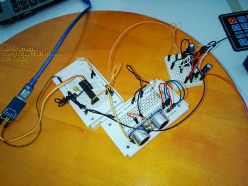

We started with some basic, like having a good power supply, Ohm's law to calculate some currents, the importance of datasheets and so on.
After that we started building a power supply that could deliver 5v and 3.3v.
As this was used in combination with a battery that has a voltage of 6v we made use of a LDO regulator to get the 5v and fed that 5v into a 3.3v regulator.
We then had 3 voltages to work with. Especially the direct use of the 6v from the battery was useful for supplying power to a servo.
We made a starterkit for every participant with all the needed parts:
Once the power supply was breadboarded it was measured with a digital multimeter to check the voltages. We then also checked a RGB led and learned what a anode and cathode was and how to determine that.
Having a good power supply it was now time to connect it to a pc by using a USB-serial adapter. We made sure the adapter was using 3.3v for its rx and tx lines and connected those wires to the MicroMite together with a ground connection. We did not use the usb power.
After some setup of computers, some needed loading drivers, and configuring Tera Term it was time to write some code.
As we already had a rgb led connected we decided that it would be nice to have a 3-color blinking led as the first program. We took the program from the Micromite manual and added some more pins. This worked great and at once people realized the simplicity of it and already started thinking about bigger and better.
The next choice was to connect the distance sensor, this just took a few minutes and again, with almost disbelieve it was realized how simple it was to accomplish this task. Sure enough we got into how to use that value to manipulate the blinking of the leds, and one suggestion was to make the led blink faster when the distance got shorter. Nice thought but it was kept for later.
Next up the temperature sensor. Then the LCD. Once this was working, some more wires needed to be connected so it took a little longer to make sure everything was wired up correctly we added a few lines to the code to display the Distance and temperature on the LCD.
The keypad followed quickly after and this was a good opportunity to explain how
interrupts are used in the Micromite.
We then connected a servo, making sure the power was coming directly from the battery as both the 5v and 3.3v were not powerful enough.
We then added some code to manipulate the servo by using the Keypad.
Then last but not least we added a potentiometer to show the Analog to Digital conversion. We also added this information on the LCD.
The last code addition was to use the potentiometer to control the servo. With a little math the 0-3.3v range was mapped to a 0.8-2.2 range for the servo values.
The Micromite was now hidden behind a bunch of wires, as we had all the components connected except the rgb led.
The MicroMite performed great!

Excellent little workshop TZA - when are you coming on your world tour to the UK?
Out of interest, are you in any of the photos?
The only possible thing I would have done different is to use the USB-to-Serial module to be the source of power and removed the 'lets build a power supply' element.
Bearing in mind you are coding using a computer, then you will have the power required. Cuts quicker to the 'wow' factor.

That makes a really interesting start for anyone interested in electronics TZ - well done - and as you say, Geoff's examples and the direct commands for the peripherals make it so easy. High school science teachers across the world must be quietly blessing Geoff for this!
Out of interest - what's the small vertical gadget with the lead on the little stand in the photo with the 'silver-haired-gentleman'?

Yes i am in one of the pictures. The one with the silver lining. :)
Silver hair comes early in our family.
I considered using the USB power but decided against it.
First it would not provide enough power for the complete build and i wanted to make it as foolproof as possible. By using only the RX/TX and ground from the USB-Serial converter there is no possibility of shorting the USB power supply.
On the first day there were people who never did any electronics and for them a little theory and building a power supply was as important as the rest. On the second day we had people who worked with microcontrollers before and on that day we used the power supplies build the day before to have more time for the MicroMite features.
There were 6 persons on each day. This allowed me and an assistant to check everyone's progress and guide them along the way. No blue smoke this weekend.
@Lou, People picked up very quickly how it worked. I am sure that hams will have no problem using the MicroMite. Go for it!
@Greg, The gadget is a USB microscope. I perticularly like this model as it has a large range. All the way to the top it was possible to have a complete breadboard on the projector. Not the best quality but good enough.I have seen Dave from eevblog do a review of it not so long ago and his impresion was also that it is a good deal.
